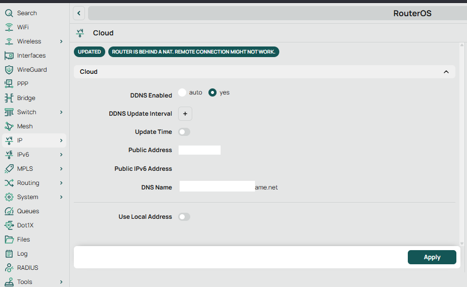

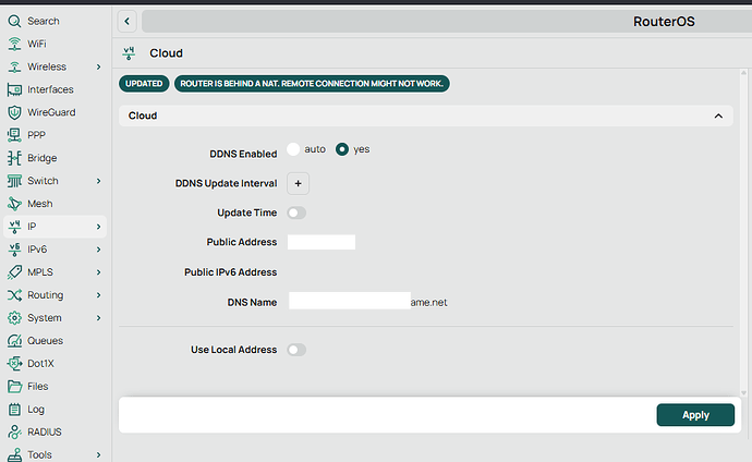

BTH needs DDNS enabled as well, do you have it? Share a screenshot of the whole IP/Cloud page if you want me to verify.
RoMON would be over EoIP. If you already have a OVPN tunnel, EoIP can go through it. EoIP is the equivalent to running a physical cable between 2 switches, you will be in the same L2 domain: EoIP - RouterOS - MikroTik Documentation
I don’t normally turn on DDNS, but I did here and I’m still not seeing anything mentioning back to home. Not even in search. And yes, it would normally be behind another NAT router I don’t control.

Everything is correct, it should appear below.
