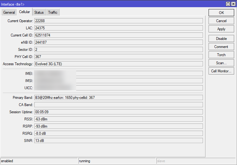

after the command is executed, the specific band/cell is regularly set as primary and the secondary band is added (in my case that of a cell in band 7), after a few minutes (about 10/12 minutes, but sometimes even less) the CA is lost, and the internet connection freezes (the session duration counter continues, but you are no longer able to surf):

Hi, they replied to the ticket like this:
This behavior is caused by the network requesting the device to handover to another cell, but as cell lock is present the device is not able to. The network is moving you from one cellID to the other to evenly distribute the load on the cells. As the device needs to follow the actions specified by the network in return it seems like the data session is dropped. Currently, no fix is available for this example, and might not be that would not contradict LTE technical specification. This information is already provided to the OEM. In these situations, cell lock should not be used.
