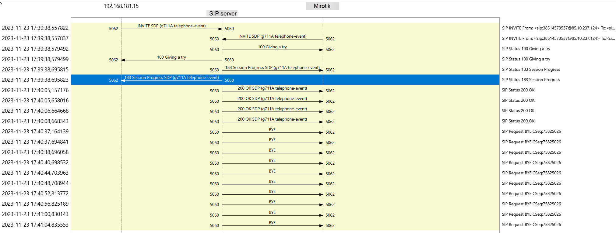

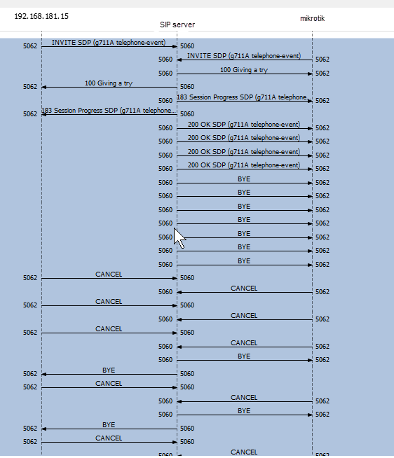

during day we have that mikrotik don’t forward bye commands during call and operator have empty line and call must be manually closed.
I have collected log but not sure what is happening.

The timestamps are missing in your screenshot, but already the 200 OK messages are not forwarded, so the timeout has to be quite short or the called party must be picking up quite late, as the normal timeout for a responded UDP session (which is this case, there were the 100 and 183 responses to the INVITE) is 180 seconds.

one of latest examples

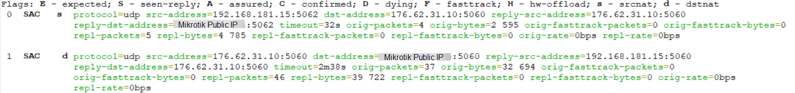

OK. Since the distance between the 183 (that went through) and the 200 OK (that didn’t) is some 27 seconds, which is far less than the UDP stream timeout on the firewall, we can exclude an issue with the normal UDP NAT. The 200 OK may be huge but the BYE should be relatively small, so issues with LAN MTU should also not be an explanation. So the next question is what does /ip firewall connection print detail where dst-address~“:506” show? Change the public addresses before posting of course.
