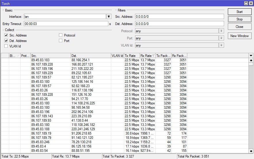

hello friends, I come here to warn you that the version 5rc1 torch has a bug in the part that shows the TX is always at 0, since the RX ta working ok …
works fine for me:
show us yours, make a screenshot and post here
Normis, yes it works on base installation (installed on VMware) but not on production router.
Kamil
Image from picture is on “production router” so it works for me :slight_smile: post screenshots of your problem
Uploaded with ImageShack.us
my router is x86… bug continua… v5rc1 bug torch x86, v5b6 not bug torch work fine…
TOTALLY UPD: yes, I can confirm such behaviour on x86. RBs don’t repeat that =)
It shows your CPU usage is %100
maybe it is the causes

could be related to multicore on x86. we are investigating.

I confirm I saw this on 5.0b6 as well the tx rx on x86 wit 82576 controller. Same problem with rc1 it shows actual traffic in torch for multiple ip addresses so this is some kind of the bug. Its good to see other people also experiencing this. Using dell r200
I can confirm the multiple IP traffic torch bug. And can reproduce it easy. Was hoping it would be fixed in rc1 :frowning:
