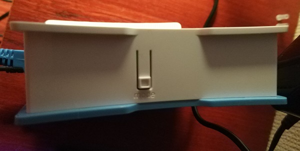

I have a question what is the mode button on the routers (for example at top of RB 941) - foto in attachment
When I press the button, there is no action (default and empty configuration).
Thank you in advance for your help
