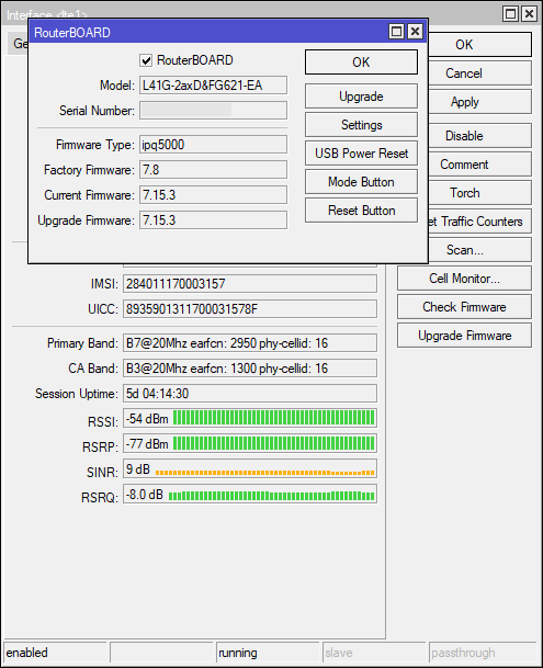

Ok updated to 7.15.3 lets see if it helps.
one annoying thing now it says in the interface list that there is a new model firmware which we don’t want to udatete just yet, any way to remove that anointing reminder?
Upgrade the lte firmware too!
is that safe in the other thread users complained about the latest firmware
I have 16121.1034.00.01.01.03
and 16121.1034.00.01.01.04 is being offered
