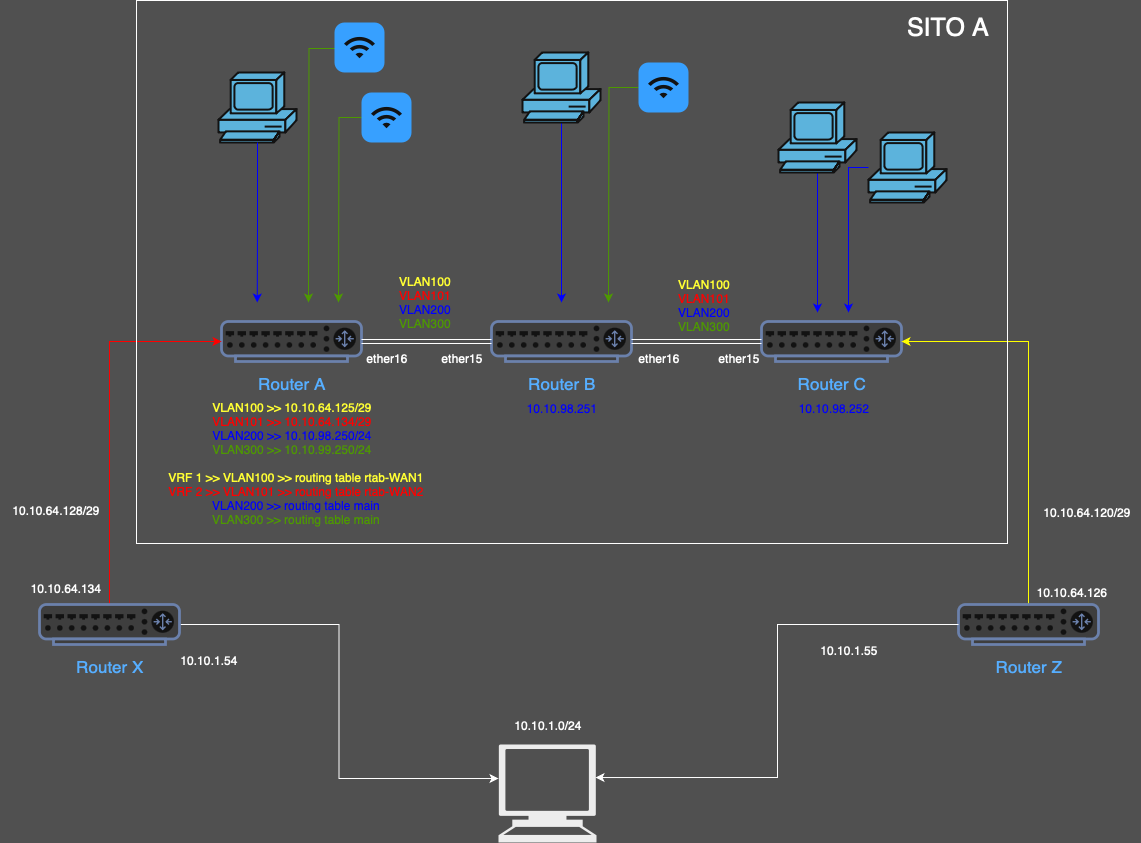

Ok, on the 2nd line:
please make an adequate network diagram.
Indeed because ...
... 2 cables in the same port on Router A ? Problematic.
router A ether16 to router B ether15
and
router B ether16 to router C ether15
router X .. .. .. . .. . . . . . . . . . router Z
router A ---- router B ---- router C
ip router Z
10.10.64.126/29
ip router X
10.10.64.134/29
ip router A
vlan100 - 10.10.64.125/29
vlan101 - 10.10.64.133/29
vlan200 - 10.10.98.250/24
vlan300 - 10.10.99.250/24
ip router B
vlan200 - 10.10.98.251/24
ip router C
vlan200 - 10.10.98.252/24
pictures are worth more than words...
also because my English isn't the best...

Concur picture worth..................
Meaning please make a detailed network diagram sufficiently labelled to know which equipment is which, where the vlans go and where the wan inputs are etc.
I try again.... :sweat_smile:
I am looking at the diagram and wondering WHY........
Why is there no wan connection clearly shown
  • should I assume you have two ISPs coming into Router A??
Why do you have 4 other routers, when all you need is switches at these locations B/C/X/Z,
aka where is the justification for routers??
Why is the PC connected to two routers are they all in the same location??? and if so where is the internet for that network.........
How are routerX and routerY connecting to the location holding Router A,B,C which seem to be colocated.

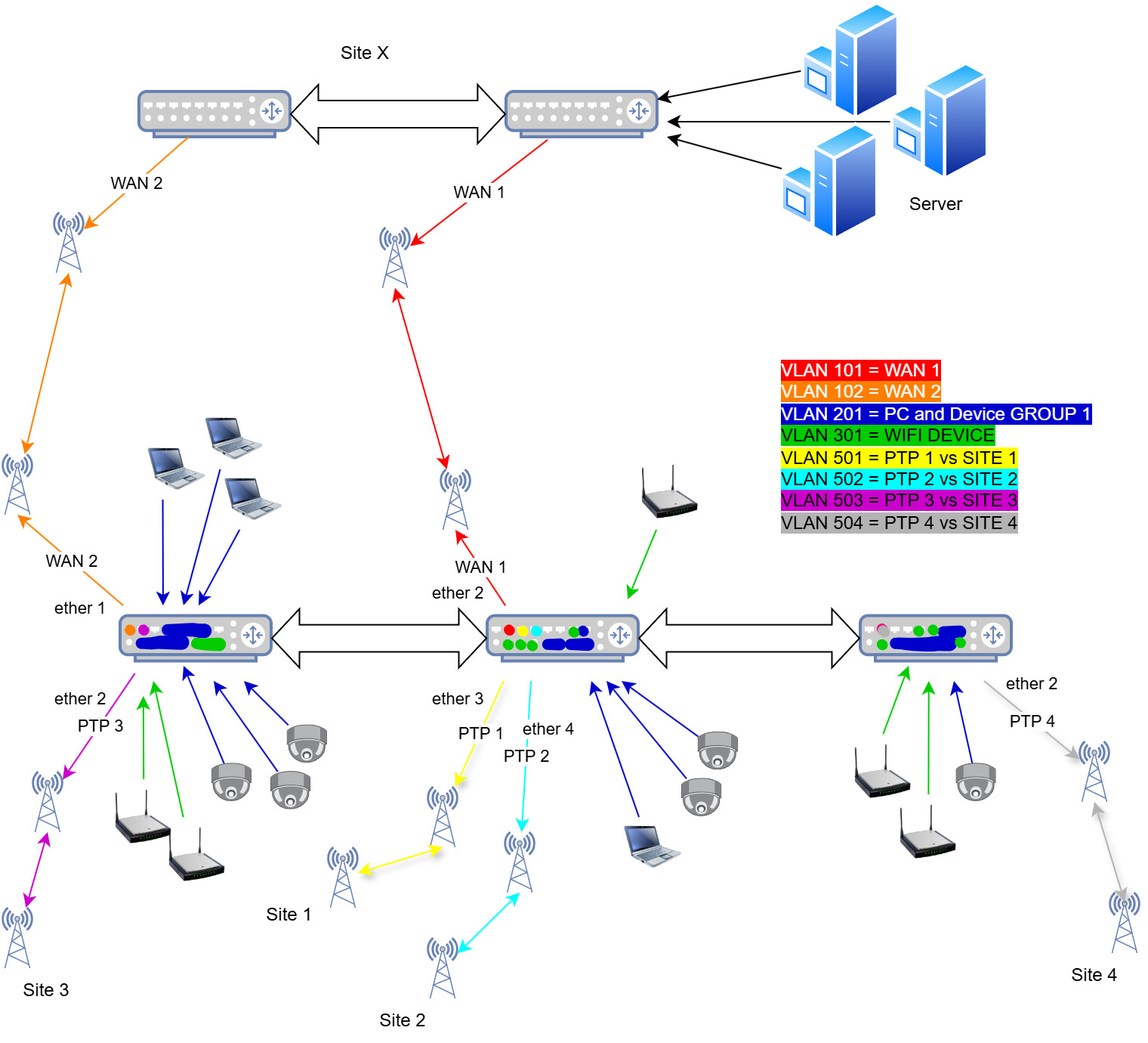

I'll try again...
This is the organization of the sites I have to manage...
on this particular site, which I am using as a starting point, I have three routers connected to each other and located on three different towers... In some ports, I have devices (PCs, cameras, IoT peripherals), in other ports I have Wi-Fi access points to provide internet on the tower itself, in specific ports I have radio links that carry the incoming network (WAN1 and WAN2) and radio links that carry the network to other subsequent sites (PTP1, PTP2, etc.)...
For this reason, I have a VLAN for each purpose:
VLAN101 for WAN1, VLAN102 for WAN2, VLAN201 for peripherals, VLAN301 for Wi-Fi, and a VLAN for each PTP line to subsequent sites, VLAN501 for PTP1, VLAN502 for PTP2, etc.
I only use one router per site to manage all routing.
I need each VLAN to be isolated from each other at the beginning, but with the possibility of forwarding specific IP addresses if necessary.
The router must forward traffic to the previous sites, giving me the option to select the desired output WAN, either for technical reasons (for example, if a site needs to undergo maintenance) or to balance network traffic on the radio links. There should be no special automation; everything must be decided manually.
Sometimes a server may be located on a subsequent site, and therefore some devices must reach it.
I won't specify the subnets currently in use so as not to complicate things... what interests me is the logic to follow...
I currently have a VRF for each VLAN, leaving the main routing table for IoT devices and Wi-Fi.
Then I manage everything at the mangle rule level.
For each configuration, I have to enter many rules,
but it works... The only thing I can't do is access the router that manages the site via the IP addresses set to act as gateways to the VLANs... I only access it via the local IP address of the WAN I use to log in.
I don't know if this is the best choice... if it can be made simpler...
I would like to know your opinion and how you would set up the configuration to do this.

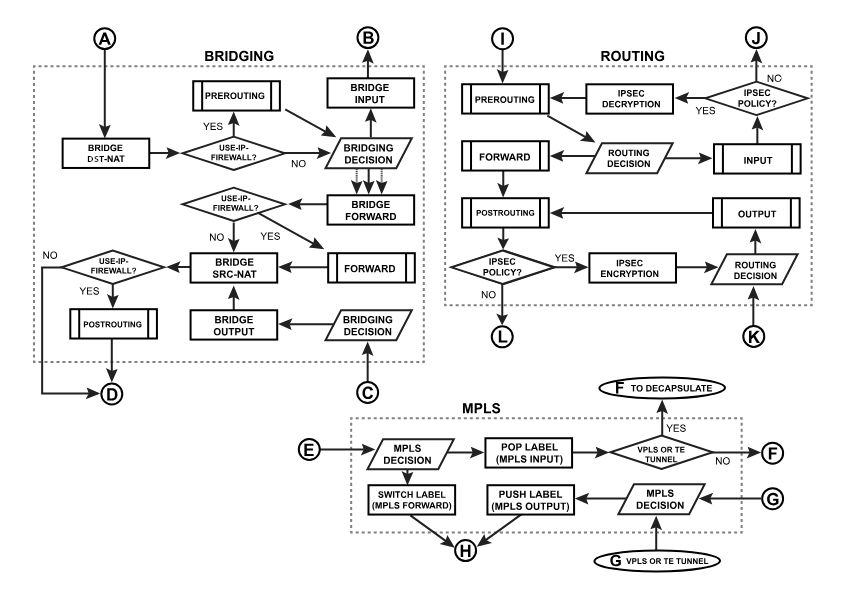

I noticed while doing some debugging that if I do routing marking from mangle to a routing table different from the one I enter, the packet does not go to the INPUT chain but directly to FORWARD... whereas if I don't do routing marking, the packet goes to the INPUT chain but gets lost there... it doesn't return from the OUTPUT chain.
(after dst-nat here)
input = something destined to the device's CPU, not forwarded.
forward = something that passes THROUGH the system, not directed to the CPU, nor even generated by the CPU.
output = something that DIDN'T previously exist and is generated by the CPU.
(before src-nat here)
Study packet flow:
I've almost got a fully functional configuration...
I'm forcing an IP address /32 that covers the LAN gateway on every VRF of the WANs...
The only thing I don't like is that I have to change the VRF connected to the Winbox and SSH services...
And then the DNS and NTP still don't work...
forward = something that passes THROUGH the system, not directed to the CPU, nor even generated > by the CPU.
I'm asking because I want to understand and learn...
I understand that once it arrives on the INPUT chain, the router will no longer route the flow... or am I wrong?
As soon as I change the routing mark, the router decides not to go to the INPUT chain anymore but goes to the FORWARD chain...
To bypass the problem of VRF management, DNS, and NTP, I tried putting both WANs on the main table while creating a VRF for vlan201
to ensure that each connection returns from the WAN it came from. I created two routing tables (rtab-WAN1 rtab-WAN2) and in each of them I entered the route 0.0.0.0/0 to the gateway for the corresponding WAN...
The problem is that even though I create the connection mark to check the incoming connection, I can't route the output... The connection doesn't go to the output chain.
It only works if I put the gateway on the main table.
But that way I could only make failover connections; I need to have the WANs in parallel.

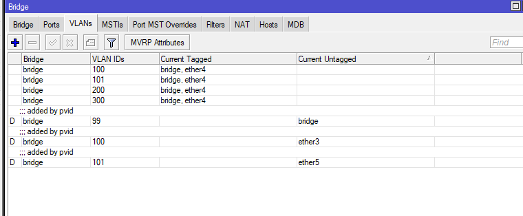

/interface bridge vlan add bridge=bridge tagged=bridge,TAGGED_Ports vlan-ids=101
/interface bridge vlan add bridge=bridge tagged=bridge,TAGGED_Ports vlan-ids=102
/interface bridge vlan add bridge=bridge tagged=bridge,TAGGED_Ports vlan-ids=201
/interface bridge vlan add bridge=bridge tagged=bridge,TAGGED_Ports vlan-ids=301
/interface bridge vlan add bridge=bridge tagged=bridge,TAGGED_Ports vlan-ids=501
/interface bridge vlan add bridge=bridge tagged=bridge,TAGGED_Ports vlan-ids=502
/interface bridge vlan add bridge=bridge tagged=bridge,TAGGED_Ports vlan-ids=503
/interface bridge vlan add bridge=bridge tagged=bridge,TAGGED_Ports vlan-ids=504

It's always a pleasure to exchange a few words in this forum... :grinning_face_with_smiling_eyes:
Okay... finally my brain has taken a step forward and I understand... (given the limitations of VRF with regard to DNS and NTP)
I should be able to achieve the same result more easily by not using VRF but blocking forwarding directly from the firewall...
My goal is to have multiple output interfaces to the internet and servers that are not in failover but simultaneous.
The individual VLANs must all be separated from each other, and the only possible forwarding is to the external router (therefore to all subnets not present locally).
Each device must respond from the same interface from which the connection entered. It is therefore chosen based on the route created on the external router (if the gateway set on the route is the IP address of WAN1 or WAN2).
As for outgoing connections generated by the router's subnets, the default setting is that everything must exit through WAN1, but using mangle rules, it is possible to select criteria that allow me to have some devices exit through WAN2.
I also need to prevent possible network loops.
This is my new configuration:
If possible, I would like to hear your opinions and advice on how to optimize it and any potential critical issues.
Thank you very much.
