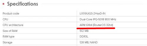

My point was that Ax Lite has an arm processor (=32 bit).
This L009 has an arm64 processor (but indeed with 32 bit ROS ?).
