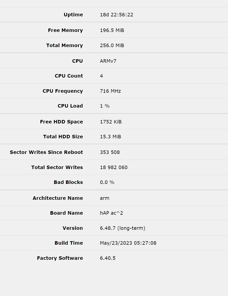

Today I’m running a HAP AC2 with two CAP AC but I’m thinking of just trying out to simplify my setup and using just one CAP AX.
I have 23 wifi devices connected currently (alot of home iot devices running) Currently with the setup I have my HAP AC is running at no load at all:

Or should I just get the CAP ax and keep the HAP AC2 and not setup capsman?
My guess is that ax isn’t going to make much difference for IoT devices.
