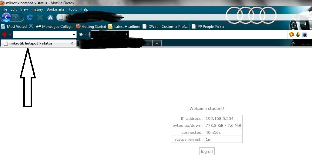

is it possible to remove the word mikrotik hotspot ( where the arrow is on the image).

and how to skip this status page all together??
I described in my last post how to make sure the status page doesn’t appear at all.
The title, obviously, is changed by editing status.html and setting a different title in the tags.
