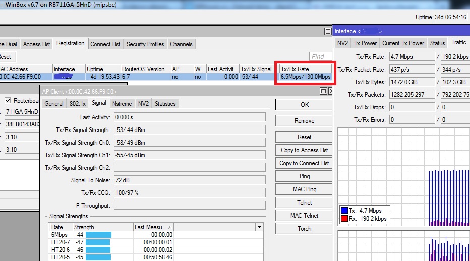

I have the exact same problem with Groove and SXT APs. TX-Rate freezes at 6.5 Mbit
So, after a while i made 2 scripts wich "watch" APs and force disconnet if needed over SNMP.

Problem persist with ROS 6.7 on both sides of P2P link. [Ticket#2013110466000664]

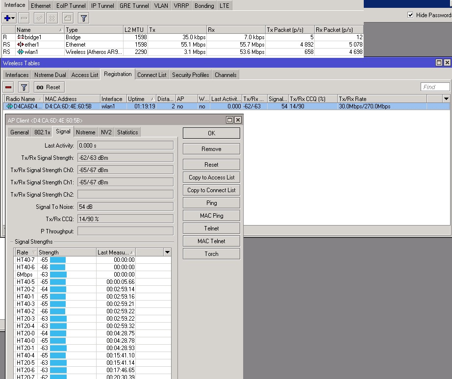

on the pictures you attached there is nothing typical to NV2 locked modulation state. If the link modulation is locked the ‘station’ side shows that
  1. in SNR measurement sorted by measurement time there is one or 2 modulation (probably low ones) in fresh state (measurement age in seconds or rather near zero seconds) and the other ones are much older (it can be hours or days - it depends on how long is the link in the locked state).
  2. TX quality is 100%
Since the 6mbps is the default modulation which is used whenever there is a need to send some information which must reach all the connected clients you will see that modulation SNR as the fresh one near all the time. Every time for example a broadcast/multicast packet is sent from AP it is send using 6mbps modulation (because any connected station must be able to receive it).
So again - on the pictures there is no locked modulation (if they are taken from ‘station’ side of the link, of course)
The second picture shows poor CCQ in RX direction…

Picture which Gazza put is NO locked modulation

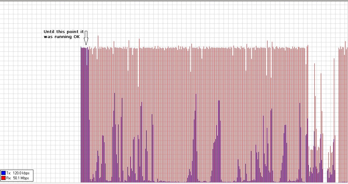

Upgraded to 6.11. Firmware 3.12.
The issue is still there just that it has other flavour.
It worked well for 30 minutes and then the connection rate (for tx in this specific case) went up and down from 6.5 to 120 Mbps. The RX stayed at 270/300 Mbps.
The throughput can be seen in the picture.
Now I upgraded both sides to firmware 3.13 and rebooted. Currently showing 270Mbps/300Mbps on both sides with BTEST udp running fixed at 50Mbps/50Mbps. I will get back with the results.
Every single link with SXT’s with dual chains enabled that I tested developed the behaviour. How cannot this issue be isolated? Really. :slight_smile:
