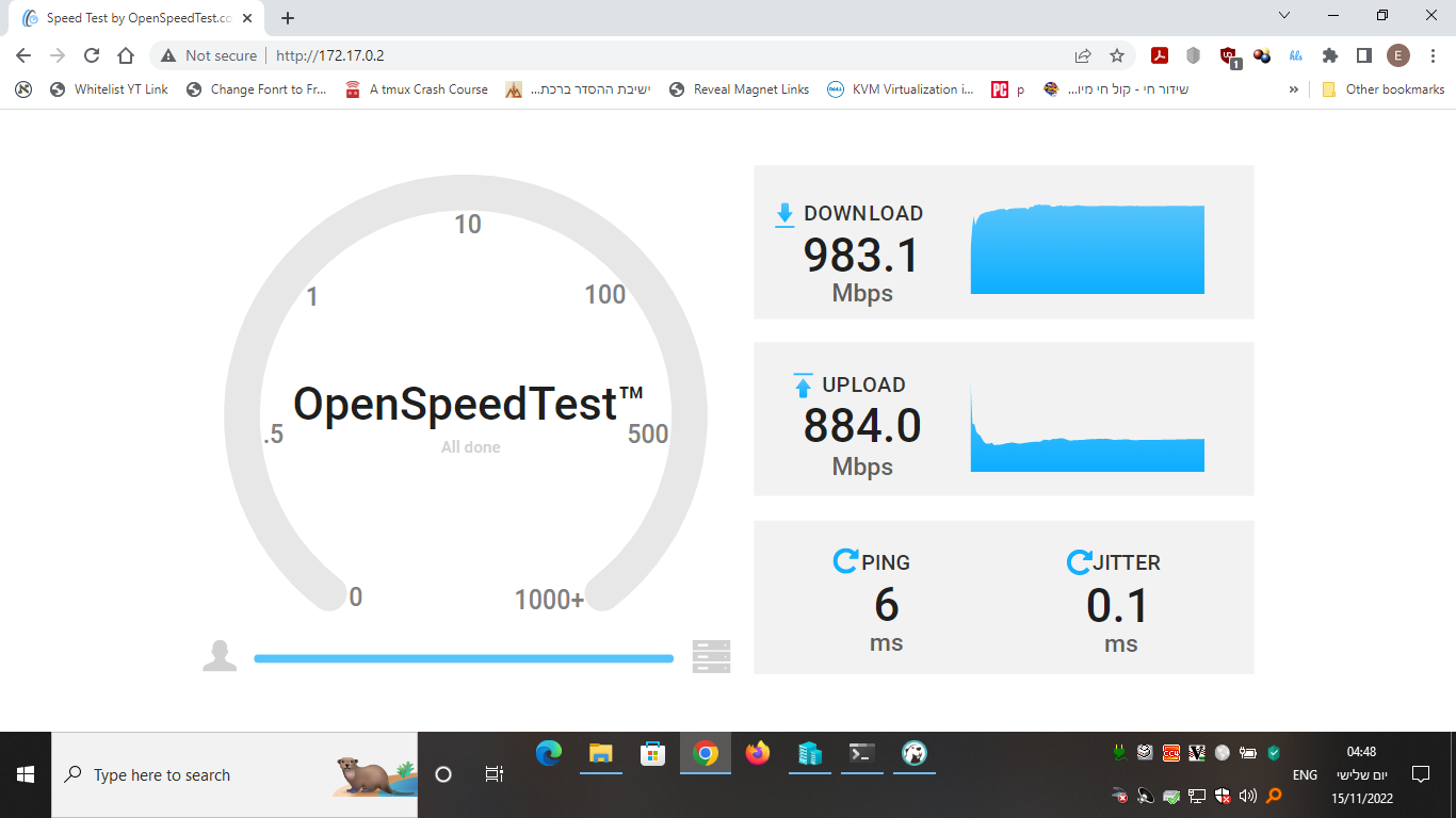

On my RB4011 I can reach easily to almost 1Gbps both upload and download.
If anyone have a 10Gbps link and can test it would be pretty nice.

(First it got max to 70% CPU utilization)
And well.. it’s based on Javascript/html5 and nginx.
It’s really a very simple speed test but well written.
There are actually two files ie downloading and upload (if I remember by heart right).
Everything is from RAM on the RB4011 and the files are 0k for the upload and the downloading is a bit bigger.
It utilizes multiple(6) tcp streams. I know that for a single stream you won’t get this speed.
The idea of this and other speedtests are to make sure that the “cable” can handle the 1Gbps and not test that every stream by itself can be streamed at 1Gbps.
Also, nginx is configured to use send_file and it makes it possible to “offload” the IO operations from RAM/DISK CACHE internally to the kernel which probably has the proper driver for the switch and interfaces.
On my tests the CPU load (for 6 streams..) doesn’t get above 70% and I believe it’s probably because of the v7 kernel.
