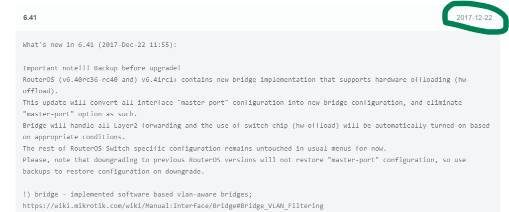

"New bridge format" ... what are you reffering to? The change that happend ago?
If you don't know the whole bridge config format changed then you don't go back very far with mikrotik :=)
Old style you had one bridge per vlan the new style many vlans per bridge
Look at diagram here to see old style

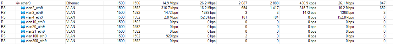

This is what a trunk port looks like in old format ... new format you only see the single port :slight_smile:
If we talk about the change from 2017, then we talk about the same "being familiar with old/new format".
Think that 8 years was enough to change configuration according the new rules or at least enough to contact with Mikrotik to solve the problem.
