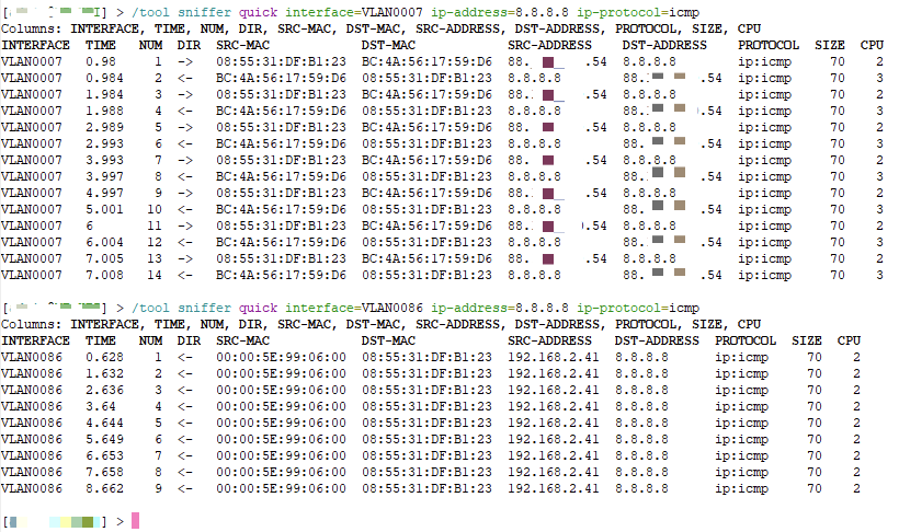

Next I checked with the sniffer tool what is going on.
So where are these reply packets, why are they not forwarded to 192.168.2.41? There are no other mangle rules, nat rules, routing rules, ipsec policies, nothing that could mess with the flow of packets in any way.

The ping response packet from 8.8.8.8 will have the connection mark C_FROM_VLAN0086, so when it arrives at the router, the router will apply the routing mark to that packet and will send that packet to 88.XX.XX.49, as you have told it to. The ISP will then send it back to you, you will send it back to the ISP, and the packet will continue to loop until the TTL expires.
Thanks mducharme!
I added the in-interface matcher to the second rule and it works. I tried a few different things, don’t know why I overlooked this.
