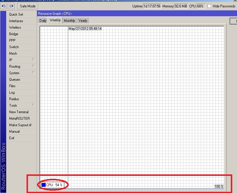

I have issue with graphing tool in winbox only with resources. RB433AH 5.17.
Interface graphing in winbox is OK. On www everything is OK. Every resource in winbox is 1px high.
ok after reading a few posts, i have reset the cpu back to 680mhz and all is fine again.
One to watch there. Somehow the upgrade to 5.17 reset the CPU back to 100mhz RB750G was on 5.3
CPU graphing is broken since at least v3
I don’t know why they don’t fix it :slight_smile:
:laughing: yeah I know right, Funny.

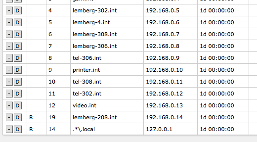

Added a new static DNS entry and it appeared as regexp.
Why is it? As you can see the old ones are not regexp.
