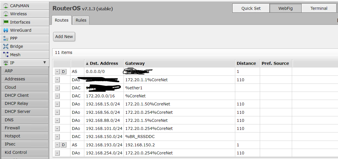

I am on 7.1.3 and both ipv4/6 routes show up in winbox.

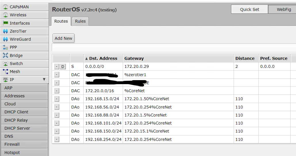

Seems fine on 7.1.3 and on 7.2RC4

elbob2002: your screenshots are exactly what im asking about. currently theres no way to select a ‘routing table’ to view/edit/etc the routes in that table, when you click on ‘ip → routes’ you are presented only with the ‘main’ (or the ‘all’) routing table. ‘tables’ have moved to ‘routing → tables’ and so i was asking if the ‘routes’ for these ‘tables’ had also moved, or if there was any idea if/when the functionality will be restored to the os7?
