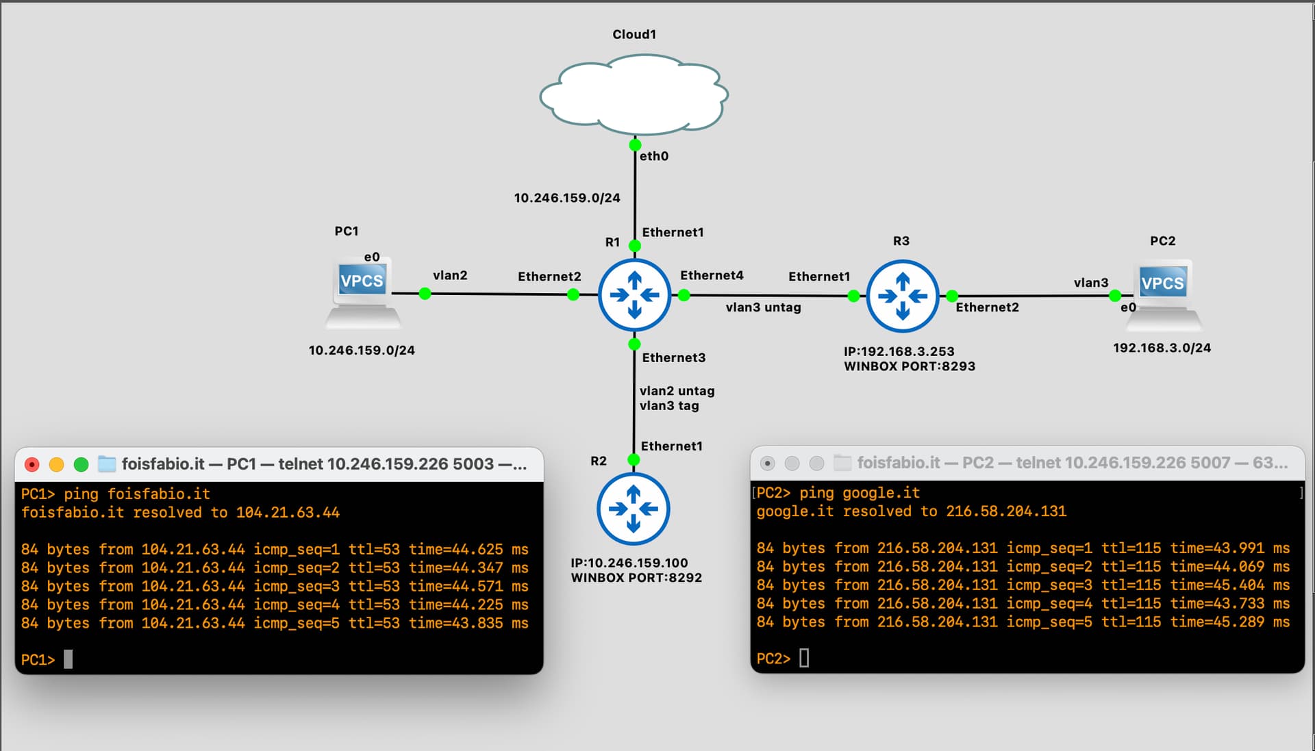

Here I am, I did some tests, in fact I confirm what @CGGXANNX said regarding the output rules and the operation is exactly as he described.
Unless someone finds a way to make the output rule work with ping, for now I'm sticking with the vrf-lan@vrf-lan gateway.
I decided to complicate the topology to make it more adaptable to a typical production topology.
The topology was transformed as shown in the following diagram, adding the dstnat (port forwarding) of R2 and R3 used for testing on gns3 (since I don't have a test web server) and VLAN filtering.
The configuration seems to be working correctly.
I notice that if I open the winbox port to R2, since it's on the vrf-lan, I need to run a routing leak in the mangle to intercept this port.
Can you confirm that the configuration I performed is correct? From my tests, it works perfectly.
I've attached the code below:

abbio90
December 5, 2025, 2:42pm
20
going back to my configuration, I can't reach 192.168.3.0/24 even if I set the route:
add disabled=no distance=1 dst-address=192.168.3.0/24 gateway=vlan3-guest@main \
routing-table=vrf-lan scope=30 suppress-hw-offload=no target-scope=10
I attach the complete configuration:

furthermore, from wireguard I cannot reach the network under vrf-lan even though I added the route:
add comment=route-return-wg1-main disabled=no distance=1 dst-address=10.110.110.0/24 gateway=wg1 routing-table=vrf-lan scope=30 suppress-hw-offload=no target-scope=10
