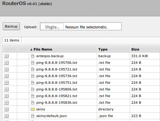

	:local tm [/system clock get time]
	:set tm ([:pick $tm 0 2] . [:pick $tm 3 5] . [:pick $tm 6 8])
	:local pgfl "ping-$target-$tm.txt"
	:execute script="{ping count=$count interface=$intf interval=$timeout $target}" file=$pgfl
	:delay ([:totime $timeout] * $count)
	:do {
		:delay .2
#		:put "...ping wait"
	} while=([:len [:file find name=$pgfl ]] = 0 || ([:find [:file get $pgfl contents] "sent="] < 0 ))
	:local resp [:file get $pgfl contents]
	:local rttpos [:find $resp "avg-rtt"]
	:set resp [:pick $resp ($rttpos + 8) ($rttpos + 15)]
	:set resp [:pick $resp 0 [:find $resp "ms"]]
	/file remove $pgfl
	:return [:tonum $resp]

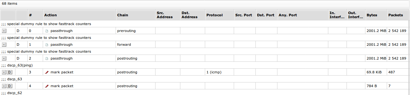

I don’t know how to write the rules correctly in mangle firewall, I added them to the bottom of those that have 2 classes 20 and 30 but what chain I use, and the other parameters how should they be configured?
In queue tree I added to the bottom as per your schema, but the parameters as Priority as they are to be compiled.?
I have a minRt of 28M and a maxRt of 31M and the script marks an error.

To mark packets based on your existing connection classificaiton, add that in your “postroute” chain of mangle table.
/ip firewall mangle
add action=mark-packet chain=postrouting comment="PMark: ???" connection-mark=??? new-packet-mark=??? passthrough=no
with ??? being your existing connection marks (created/defined on upload mangle)

add action=mark-packet chain=postrouting comment=dscp_63 dscp=63 \
    new-packet-mark=dscp_63 passthrough=no
add action=mark-packet chain=postrouting comment=dscp_62 dscp=62 \
    new-packet-mark=dscp_62 passthrough=no
add action=mark-packet chain=postrouting comment=dscp_61 dscp=61 \
    new-packet-mark=dscp_61 passthrough=no
add action=mark-packet chain=postrouting comment=dscp_60 dscp=60 \
    new-packet-mark=dscp_60 passthrough=no
add action=mark-packet chain=postrouting comment=dscp_59 dscp=59 \
    new-packet-mark=dscp_59 passthrough=no
add action=mark-packet chain=postrouting comment=dscp_58 dscp=58 \
    new-packet-mark=dscp_58 passthrough=no
add action=mark-packet chain=postrouting comment=dscp_57 dscp=57 \
    new-packet-mark=dscp_57 passthrough=no
add action=mark-packet chain=postrouting comment=dscp_56 dscp=56 \

  • Can you take a look at my configuration now that I have changed it?
  • Outgoing queue queue (DSCP_pppoe-out1) has a queue-type=default-small and subordinates have queue-type=ethernet-default.
  • Is ping prioritized? How do I set it?
Do I have to create incoming queues (Downloads) by copying all outgoing queue and copying 64 additional rules to the firewall mangle?

I’m looking into the issue with file deletion…
Update: fixed.
Should the rule to prioritise pinging be put in front of everyone?
Rule is being invoked: processed 487 packets. Verify that it gets in right queue. Your queues have counts too…
  • I also checked queue 63 and there is traffic.
  • fasttrack bypassed with this
/ip firewall filter add action=accept chain=forward comment="Bypass fasttrack for non-zero DSCP" connection-state=established,related dscp=!0
Are just a step away from the solution… :laughing: :laughing: :laughing: but the latency is always very high, both up and down!!
