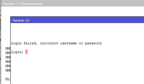

@Amm0, thank for finding that and it indeed closes the terminal (CLI) in the Winbox of the user that does not exits anymore. Disabled user is an other possible option.
This is can select the correct user to be booted from the terminal. Winbox seems to cache stuff and with that it can reconnect.
:foreach item in=[/user/active find] do={:if ([/user find name=[/user/active get $item]->"name"]) do={} else={:do {/user/active request-logout $item} on-error={:put "bugger"}}}
bugger
01:12:47 echo: system,error,critical login failure for user test from 192.168.0.11 via local
Displayed in the second Winbox, where the user has been requested to log out:
Then who want to do more tests which other connections it closes. It does not close Winbox. Terminal is closed and logging in again is not allowed.
