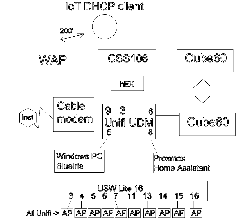

The IoT client connects to the WAP, which is wired to a CSS106, which is wired to a Cube60. The other Cube60 is wired to a Unifi switch, which is wired to a Unifi UDM, which has a hEX hanging off of it. The WAP serves DHCP (I was hoping only for it’s wifi-connected devices, but I see now that it not the case), and the hEX serves DHCP for the rest of the network. Diagram below.
I could simply disable the DHCP server on the WAP and let the hEX serve all clients. I can’t remember exactly why I set it up this way originally.

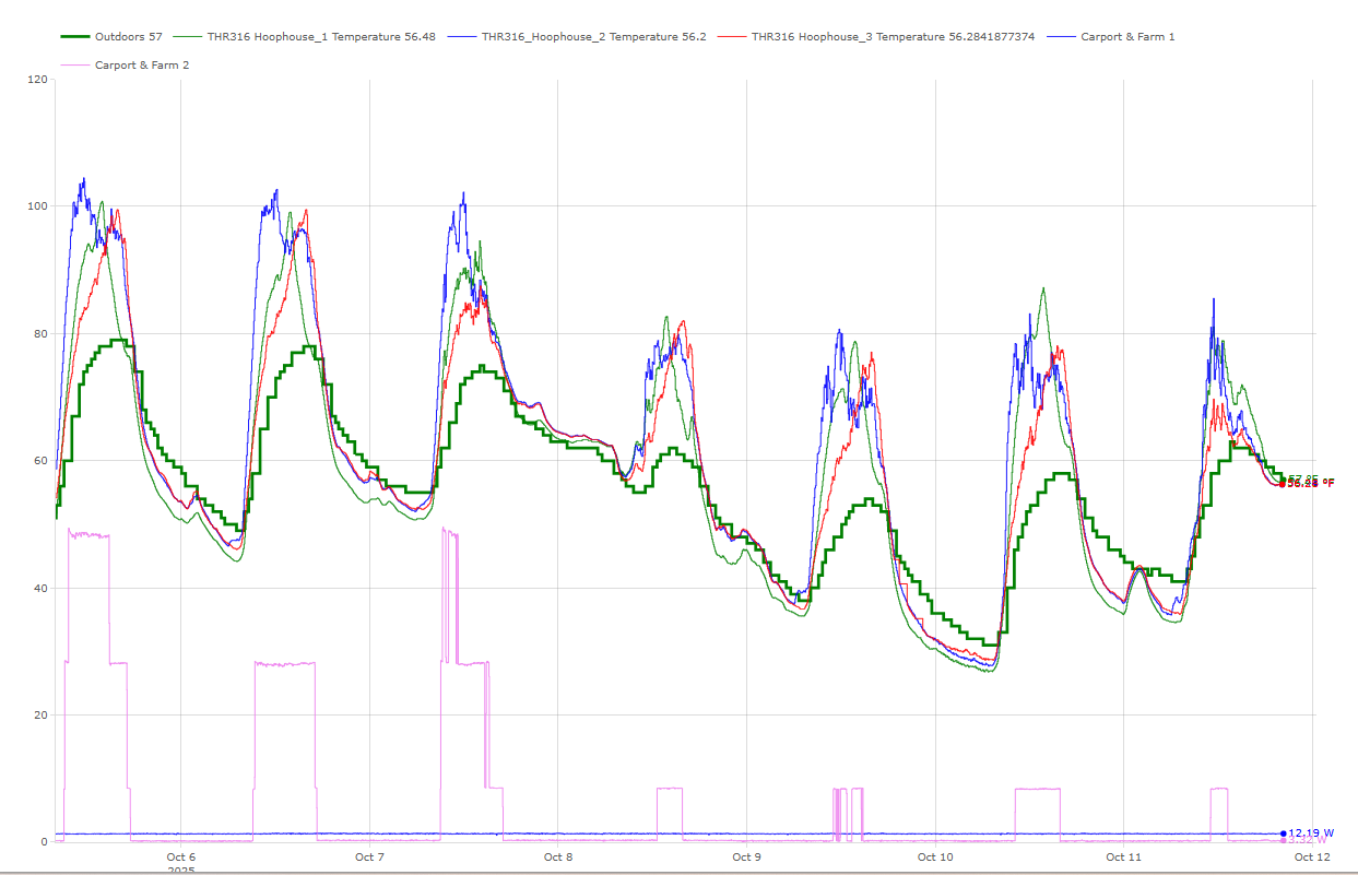

Here is an example of the data collected and managed by a Home Assistant server from these hoophouses:

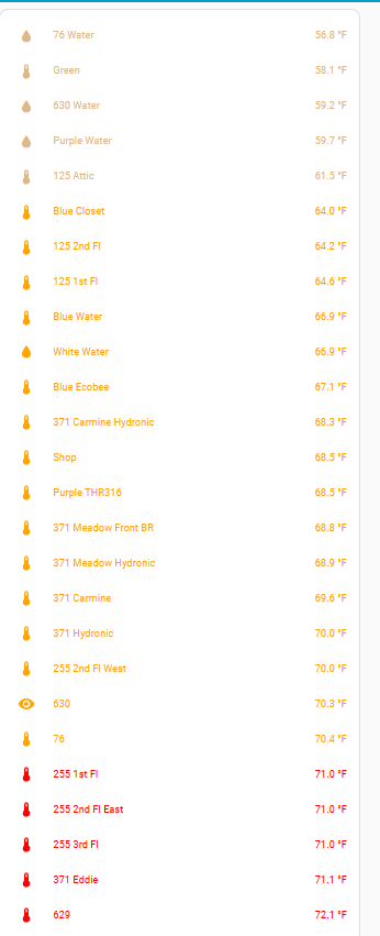

And here are some of the current temperatures at various locations:

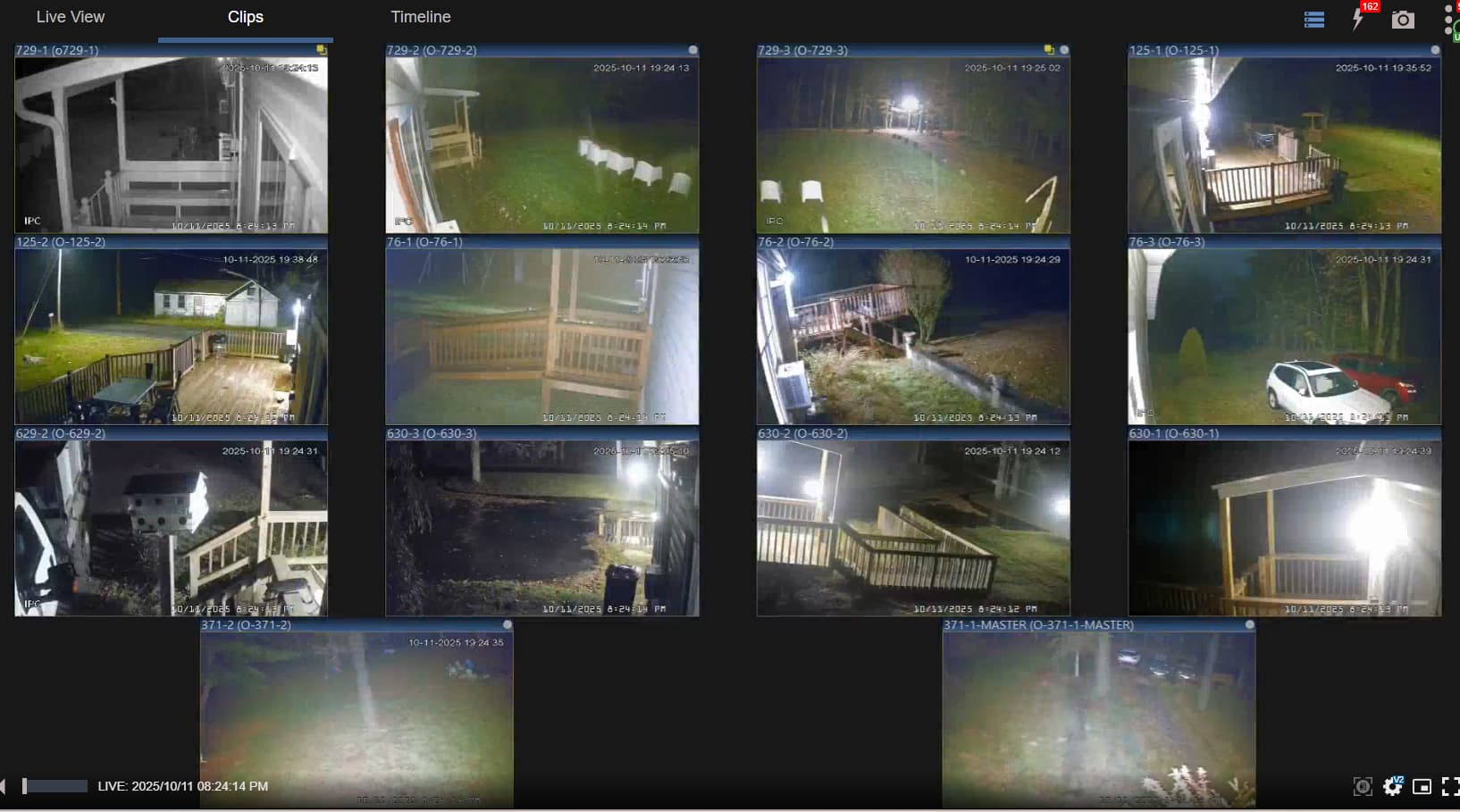

And here is a screenshot of the live video feeds:

Here is a bigger diagram of the network.
The UDM is connected to the cable modem for Internet access and serves as the main router.
The hex does the following (and only the following): DHCP & DNS server, and wireguard peer to provide WG connectivity.
One remote site has a UDM and Unifi cameras. All other remote sites are fully Mikrotik equipment.
Below is just the one site about which I started this thread.
So UDM is running Network and Protect applications I presume. I think Unifi also supports wire guard. Why don’t you let UDM hande DHCP and DNS ?
UDM is running Network.
I use a Blue Iris server on port 5 of the UDM because the cameras (at this site) are not Ubiquiti (I actually don’t know if Protect can handle non-Ubiquiti cameras).
I use the hEX for DHCP/DNS/WG because I wanted to learn.
This environment (like many, I suspect) has been a work-in-progress for 8 years. For example, the BI server preceeded the UI equipment, and the hEX was added after the UI equipment.
I have a dream of replacing the UI equipment with MT, configured with VLANs. It’s a huge (and scary) project for me.

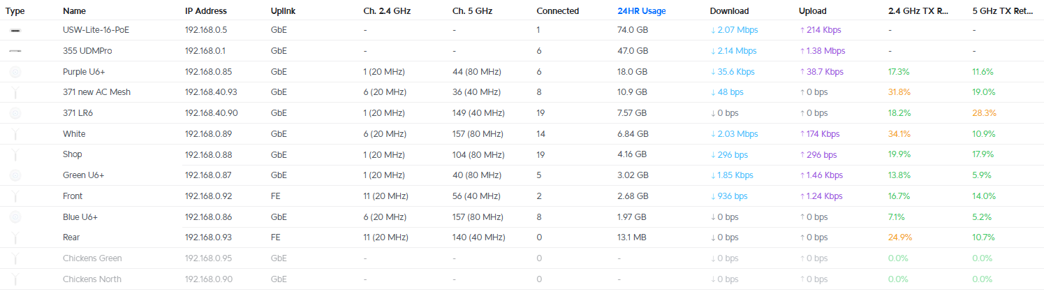

Here is the UI devices dashboard:
