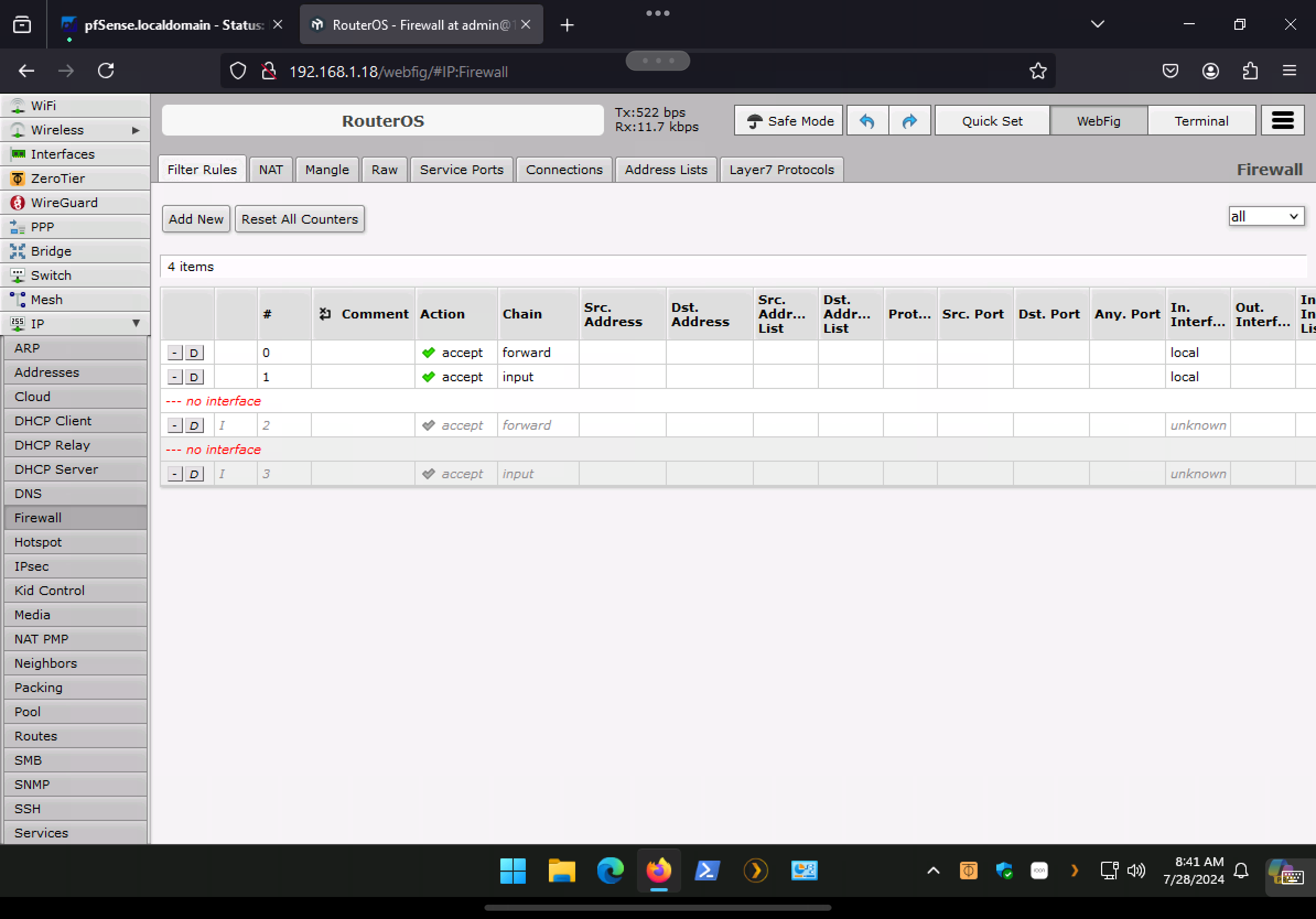

Hi, I am running a MikroTik CRS309-1G-8S+ as a switch for my 10G network using RouterOS. However, it is not performing any routing (it’s simply connected to my main router) and there are no firewall rules running. I am able to follow the MikroTik documentation to enable ZeroTier and I see the MikroTik device on my network on my.zerotier.com. However, when I try to do:
/ip firewall filter add action=accept chain=forward in-interface=zerotier1 place-before=0
/ip firewall filter add action=accept chain=input in-interface=zerotier1 place-before=0
I get a No such item error. I tried to run those same command without the place-before=0 and while that allows the command to run without error, I am unable to connect to my home network remotely.

Thanks for your help. I was able to correct that error. The problem was my interfaces entry for ZT was not correct. However, after being able to add the two rules above, I am getting the errors that those rules cannot be used on an interface that is a slave. Not sure what that means…error is below:
And this is what Interfaces look like:
I edited both rules to reference local, but I still cannot connect remotely.
Thank you.
The zerotier1 interface is part of (or belonging to or slave to) the bridge named “local”.
It should be “self-standing” (out of the bridge), otherwise the /ip firewall filter rules will never get used.
No idea how or why it was made part of the bridge, but maybe you are setting everything bridged, so you don’t need at all those rules.
