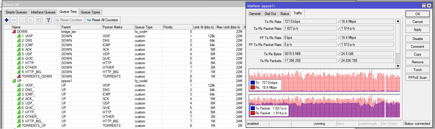

In the screenshot below, you can see I lowered the max-limit of the queue to 80M but still my pppoe traffic overshoots to 96M.
