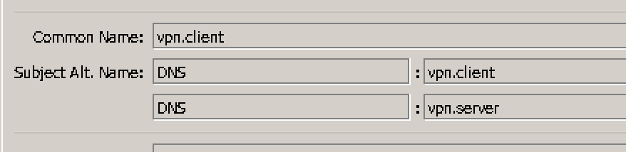

Not yet - Emil from support suggested to check the certificate to include the subject alternative names of local and remote id which didn’t help (i just tried it with the client certificate)
SOLVED:
Thx to Emils Z. from support.
He pointed out, that in iOS13 & macOS Catalina “Apple has added SAN certificate field verification and it fails in the new version because your certificates does not have any Subject Alt”.
I re-created both certificates for client & server with subject alternative names field (SAN) configured:
Solution: create certificates with SAN fields configured
Now it’s working on iO13 and macOS catalina

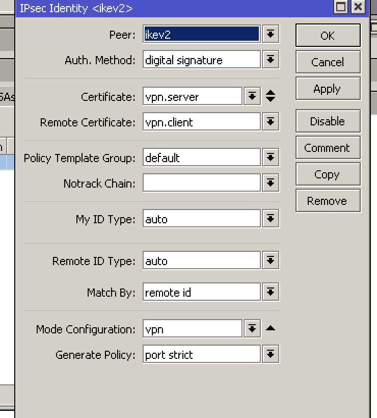

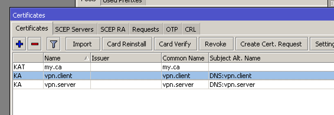

Can you show screenshots of your certs?
Yes, I changed the certificates.
You setup for the peer is different of mine. Wondering if that can be another of the reason. BTW, what RouterOS version are you running? Mine (6.43.:sunglasses: doesn’t look like yours.
I’m on the most current 6.45.7
this is my config:

/certificate print
Flags: K - private-key, L - crl, C - smart-card-key, A - authority, I - issued, R - revoked, E - expired, T - trusted
 #         NAME                                   COMMON-NAME                                 SUBJECT-ALT-NAME                                                              FINGERPRINT
 0 K  A  T my.ca                                  my.ca
 1 K  A    vpn.server                             vpn.server                                  DNS:vpn.server
 2 K  A    vpn.client                             vpn.client                                  DNS:vpn.client
