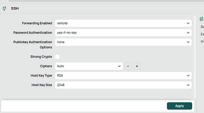

Did you ever find the cause of this? I’m experiencing a similar issue that I think might be related to ssh forwarding? I use that feature on a regular basis and noticed it had been totally disabled after upgrading from 7.15 to 7.20.4. It no longer seems to function as expected and choosing any option other than “no” seems to intermittently break SSH altogether for me. SSH just hangs entirely or hangs for a brief period before resuming. I read through the changelogs and poked around a bit before turning to the forum. Changing it back to “no” seems to make SSH function as expected again.
I’ll keep messing around and check out other routers which were recently upgraded but so far everything I’ve tried points to a firmware issue and not a problem with my setup.
