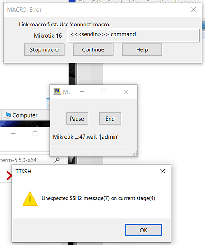

The failure message looks like this.
  1. The top message is the macro freaking out that I’m trying to use commands that need an active connection which doesn’t exist due to the error at the bottom.)
  2. The second message is the macro itself just displaying that it’s at line 47 in the macro waiting for ‘[admin’ to appear in the console
  3. This is the error message TTSSH is giving when trying to connect to the Mikrotik.
