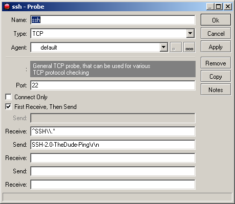

All devices are probed by dude every minute or so. When i reboot device, ssh works, and these errors begins after 1-2 days.
I disabled ssh on one of devices.
this is my dude ssh probe:
It looks like dude’s fault, because, when i stoped probing, i can ssh normaly to device. O my custom probe problem. Maybe something with ssh server, because there is no ssh connections in /ip firewall connections.

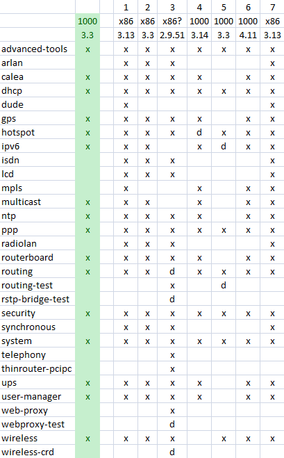

I have a little more information that may help:
When I said this was a problem on all x86 and RB1000s I was wrong there. I have one RB1000 that is working. I checked to see what packages it is running and compared it to the ones that are not working. (See attached image)
The RB1000 that is working is shaded in green and I have marked what packages that are installed and active with an ‘x’ and the packages that are installed and disabled are marked with a ‘d’. Blank spaces mean that package is not installed at all.
The top of each row indicated the type of router and the OS version it is running.
Using FileZilla in Windows 7 I can manually connect to routers 1 and 5 with SFTP using a username and password for the account that the public SSH is key is setup for. (I have not tried using the public key in FileZilla) The error I get in FileZilla on the others is:
