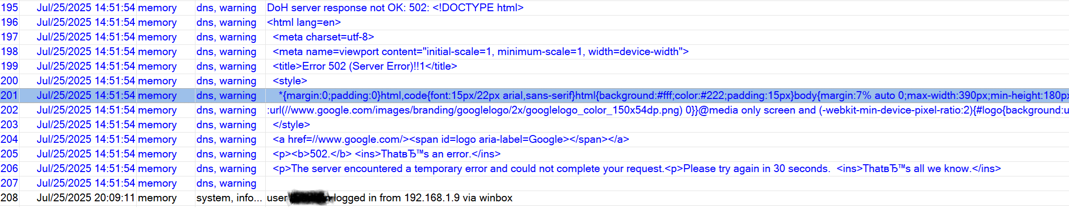

Strange warnings in the DOH logs
Router: E50UG
ROS: ver.7.19.2
DoH: Google - 8.8.4.4
Is this an incorrect handling of the 502 error, or is this how it should be?
DoH itself works flawlessly, there are occasional errors like "DoH server connection error… ", but this does not affect the operation of the router in any way.

And my question was WHY did E50UG decide to output to the log as a warnings the full raw html response without any filter?
On my opinion it looks like a ROS handler error.
But who knows - may be by design...
Your neighbour could be causing the requests, if you share an IP or a subnet, Google could be blocking everyone. Just try another server and see if the issue still happens.
I agree that the full HTML should not be going into the log, we will see how to fix that. But 502 is a server error and not MikroTiks
Also why is there grammar errors in the 502 HTML and some funky tags? Could you actually be using another server, not google? Very suspicious. Have you turned on verify-doh-cert=yes and imported the real google certificates? This looks like some hacking attempt to me

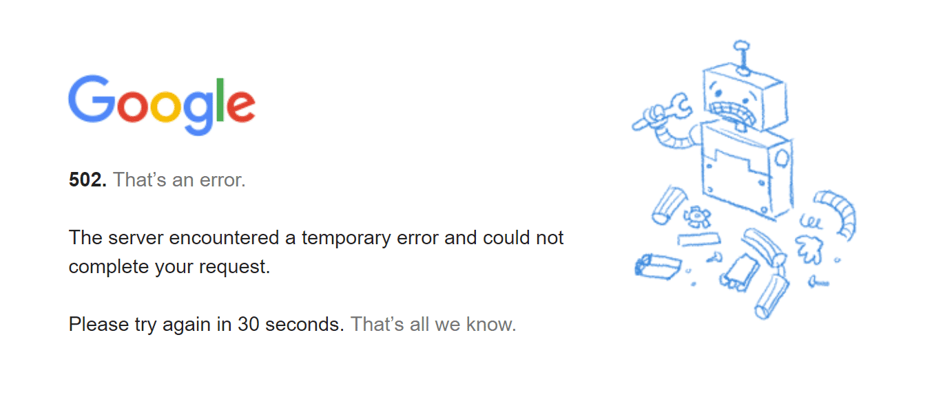

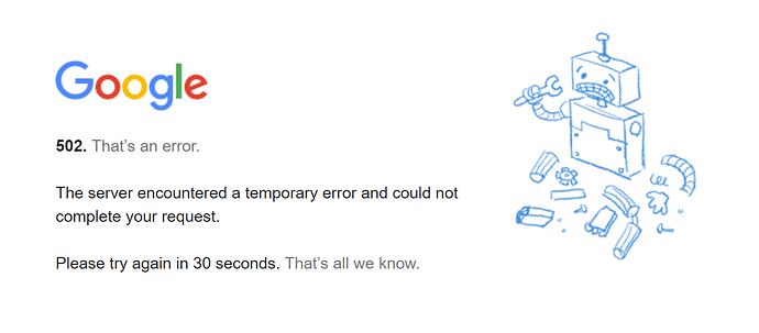

That’s Google’s standard 5xx error page, it looks like this if you happen to catch it in your browser:
The funky characters are just the UTF-8 of the “smart apostrophe” character displayed in WinBox 3 using ISO 8859-1.
That page actually has typos and this thing with “!!!111”?

Specifically, in my case, it was a single Google server error and it was visible in the logs, but it is almost impossible to recreate such an error for analysis.
Great!!!
That was the purpose of my post - to draw attention to the incorrect operation of the error handler, specifically for 502.
Thank you for the attention to this matter!
NB, other 502 DNS errors get properly shown in the log as messages, only in this specific instance something differs, we will check what
