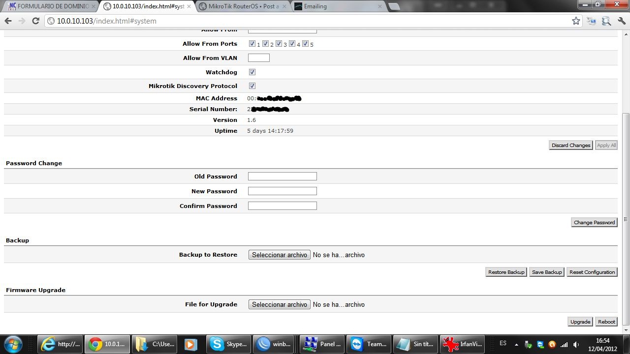

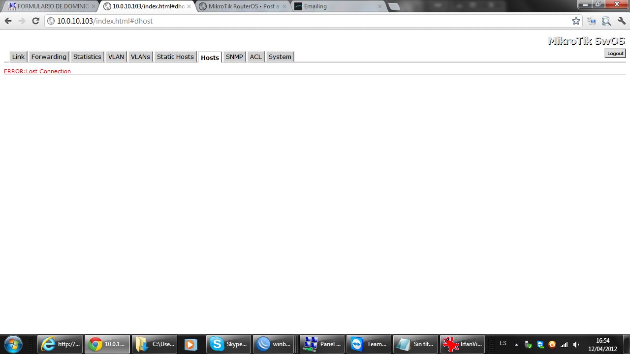

the web page send me it error in this sw with SwOS 1.6
connected in our ports a dish ubnt and 3 rb411

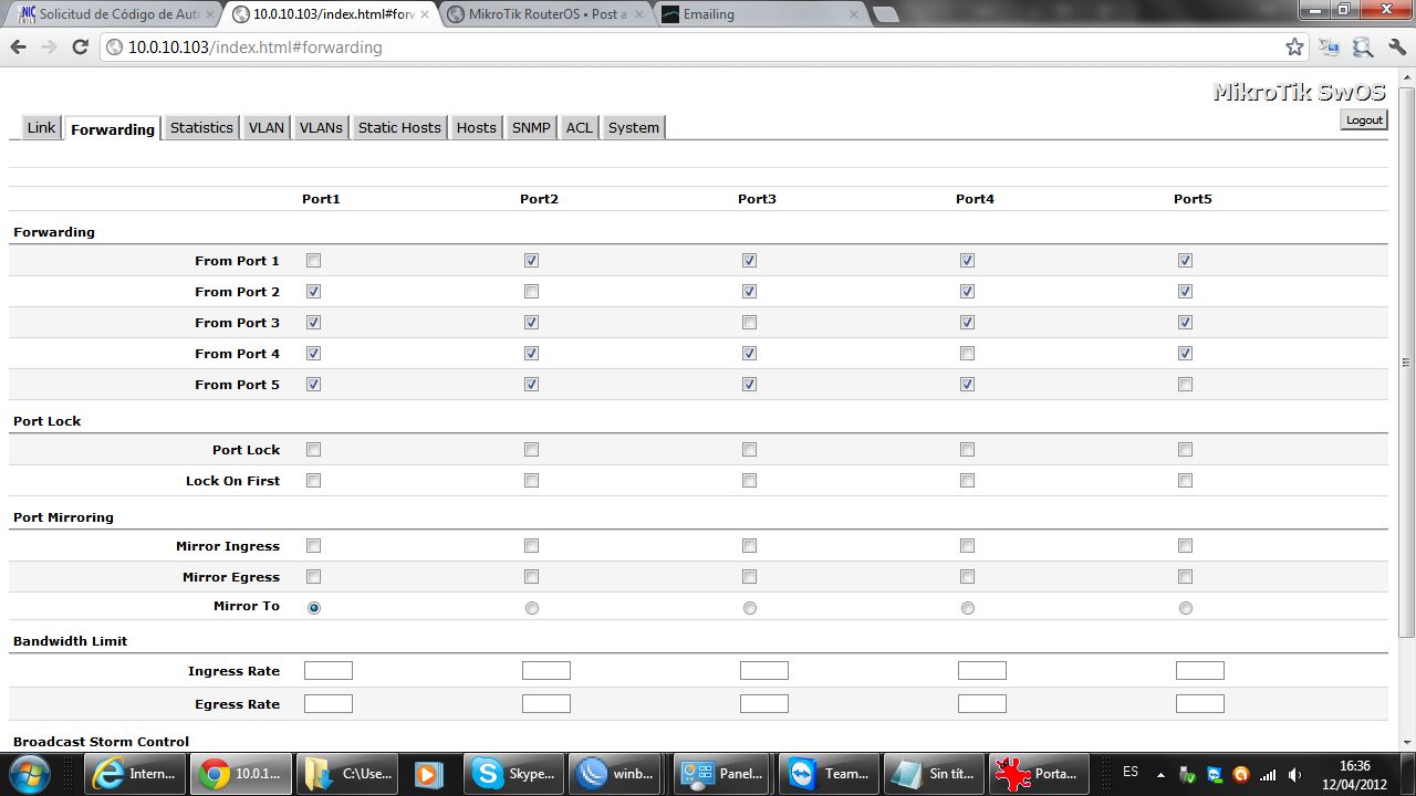

How many hosts are there in host table, how much traffic is going through the switch and whats the ping latency?
I can not see the table of host, but must be 20 host, my isp is 10Mb up and down… my traffic 4 or 5 mbps per point to host … irregularly ping latency in some host :
64 byte ping: ttl=255 time<2 ms
or
64 byte ping: ttl=255 time<800 ms
or
more and have some “time out” or "no route to host " intermittently
have diferents ping in diferents hosts, in some host can not enter by telnet, have falls in all hosts and the system works very bad intermittently.
but my problem on web interface is even if directly connected.
http://forum.mikrotik.com/t/swos-web-interface-error/44351/1
Same as here, I reported this same problem but without any respond so dont count for too much.
reinstall the firmware, with this I can see now the host,
create a vlan to route traffic to output port 1 everything works fine now
… not the reason for the error but now work fine the sw

ive got the same issue, not able to see hosts.
(see also http://forum.mikrotik.com/t/swos-web-interface-error/44351/1 )
after looking at http://192.168.88.1/!dhost.b i guess it could be some bridge loop or similar.
i get this output:
[{adr:‘44d9e7ff7191’,prt:0x02,drp:0x00,mir:0x00,sts:0x07,vid:0x01dc},{adr:‘44d9e7ff7191’,prt:0x02,drp:0x00,mir:0x00,sts:0x07,vid:0x01dc},{adr:‘44d9e7ff7191’,prt:0x02,drp:0x00,mir:0x00,sts:0x07,vid:0x01dc},{adr:‘44d9e7ff7191’,prt:0x02,drp:0x00,mir:0x00,sts:0x07,vid:0x01dc},{adr:‘44d9e7ff7191’,prt:0x02,drp:0x00,mir:0x00,sts:0x07,vid:0x01dc},{adr:‘44d9e7ff7191’,prt:0x02,drp:0x00,mir:0x00,sts:0x07,vid:0x01dc},
…about 100 lines of it…
adr is the macaddress of the vlan-trunkport of my router, so this is correct. prt is port i guess, also correct, router is on port2.
then vid should be then vlan id? this is strange, 01dc in hex is 476 in decimal and i dont know anything about vlan476 ?
im using vlan ids 1100/1500/1660
strange, even after reboot of switch and/or router its the same behaviour.
else everything works ok, ping, vlan, everything is cool just displaying hosts doesnt work but thats not important in my case cause everything else works fine.

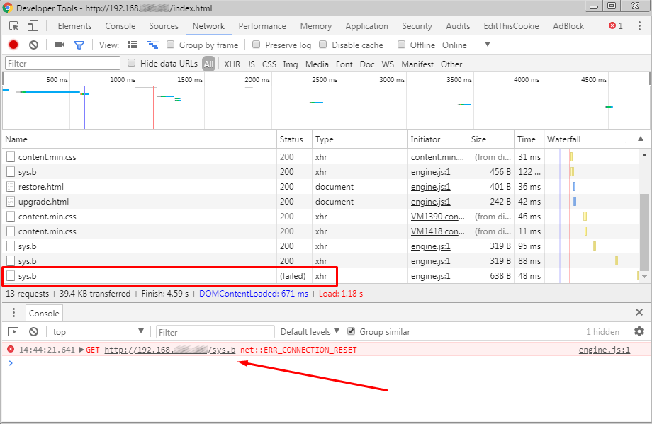

There is the userscript to solve this issue: https://github.com/azurre/mikrotik-lost-connection-fix
Tested on SwOS v1.14, v1.17. Fix won’t work on SwOS v2.xx
Has anyone try that script to fix the error lost connection on SwOS?
Curious if this worked for anyone. Running latest version 2.11 and still have the issue remoting in.
Fix won’t work on v2.xx
