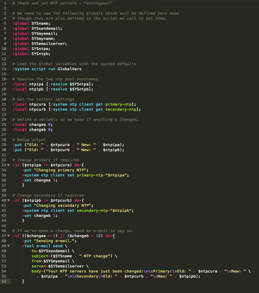

Syntax highlighting and completions for Sublime Text
I’m happy to introduce the missing support for syntax highlighting and completions in the Sublime Text editor.
Features:
  • Highlight comments, strings, parameters, variable storage modifiers and commands
  • Highlight errors like trailing symbols before the comment sign
  • Completions for most parameters and commands
  • Snippets for all loops and control statements
ToDo:
  • Add proper support for line continuation
  • Provide completions depending on the parameter
The package is available via Package Control or you can download it from github.

It does however require a programming code (as opposed to the current declarative code) that will connect to the router via SSH, and parse the SSH output to generate completion files. That’s not the same as having an interpreter (since a “?” doesn’t tell you how the command will be executed or the result of it - it just tells you its syntax), but indeed requires a different approach from the current one.
This is interesting, but I don’t think this functionality needs to be integrated in Sublime Text. Instead, one should have a shell script that connects to a given router, reads commands via “?” and then create/modify tmLanguage and sublime-completions files.
That would be cool.
That alone would be cool too. I mean, IMHO, it would be more convenient to have it right in the editor (especially if you have multiple routers, and want to switch them on the fly), but even if it’s a stand alone program, it would still be better than any “static” syntax highlighter (read: the current one and every other highlighter before it).
Wow this is awesome, just what I was looking for. - Do you accept donations? It would be nice if this stayed maintained and looked after.
Just FYI…
A while after I had posted that last message, I taught a course on networks that included MikroTik basics, and I gave students an (optional) assignment to make such an application… And because we’re talking 3rd year computer science bachelors here, guess what - one of them actually did it! Well… to be more precise, as assigned, he made an SSH-to-JSON translator.
Check it out:
https://github.com/boenrobot/ROSMenuLister
You could take the generated JSON, and transform it into hints for Sublime Text and/or other IDEs. Doing so should (at least in theory) be far easier than if you had to also do the SSH parsing.
I’ll be taking over that project, so if you have means to make it more user/developer friendly (as it surely needs to be…), feel free to send pull requests.
@ boen_robot Would be awesome if you run this script against every release of ROS and publish it e.g. as Github Release. I’ll then turn it into syntax highlighting for Sublime Text!
That’s not a good idea…
In developing this further to include hints for argument values, I’ve noticed RouterOS offers not only completions for “standard” values, but in many places, also for current state strings, such as queue names, hotspot usernames, interface names and the like… And it’s impossible to programmatically (and without heuristics) tell whether a string is a standard value or not (except the places where the values “yes” and “no” are green; That’s unambiguously standard values, compatible with a Boolean variable value).
If I pre-generate the JSON against my own (empty) VM, users would not get such string completions as part of their hints. Furthermore, they’ll see “ether1”, even if they use another name for their first Ethernet adapter… And I think using “ether1” in such cases might cause errors.
If you publish a “one click” generator for Sublime hints (which automatically invokes the SSH-to-JSON converter, and then converts the JSON to Sublime hints), users could just invoke it once against their router, and perhaps regenerate as needed.
I’m trying to refactor the convertor to be a more “on-the-fly” application, as opposed to pre-generating hints, as generating the entire JSON file takes quite a few minutes (like, around half an hour last I tested…), and most users use only a fraction of RouterOS’ features. This is a little harder then it might sound at first though, because it’s not just about invoking an arbitrary check, but “caching” the generated stuff, and making it searchable in a more efficient fashion (by making the names of menus/commands/arguments be object keys, as opposed to the current object values).
When this refactoring is done, it would become possible to create plugins for editors that generate hints on-the-fly, rather than pre-generating them, and the JSON file will simply be used as a “long term cache”. Again, I don’t know if SublimeText in particular has plugin facilities, but if it does, this would be the key to making such a plug in work. Said hypothetical plugin would tokenize each line, and lookup suggestions token by token (using the last hints to know what kind of token to lookup next), in the end generating only hints for stuff that the user actually “touches” with their scripts (and would of course also generate hints for the current cursor position), and show warnings when a token is not parsable (e.g. using a command that’s not available in the current version). The full generator would still be an option of course, so that should not deter you from making a JSON-to-SublimeText convertor “now”.
