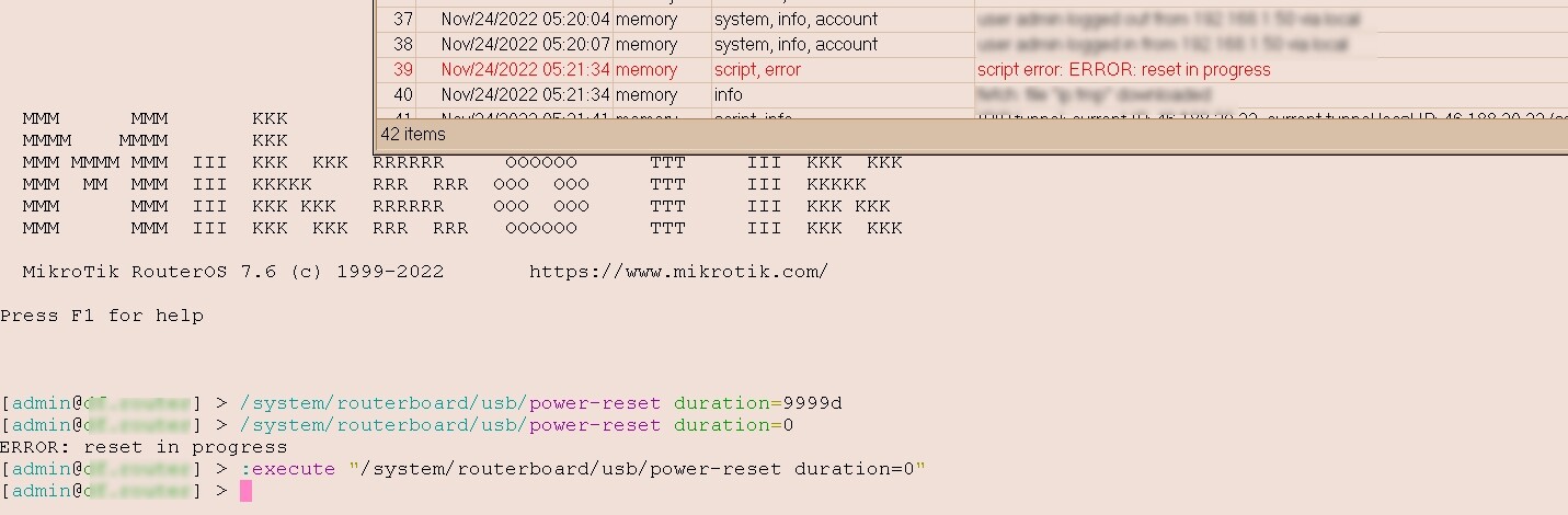

Hello, I’m having issue with ROS 7.6 regarding to
/system routerboard usb power-reset duration=9999d

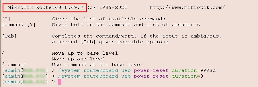

In ROS 6 I was able to issue
/system routerboard usb power-reset duration=0
and didn’t get any error, but in ROS 7 if I do the same, I’m getting “ERROR: reset in progress”
Moreover, entire script using this code is halted with the same error and even do { } on-error={} construction dosn’t help to catch the error.
And after duration=9999d (this is more than 27 years) the only way to reset USB in ROS 7 is to reboot router
This was a VERY USEFUL feature in ROS 6 and it’s broken in ROS 7.

Tested at least on two different devices running ROS 7.6
Any comments regarding this issue are appreciated.
