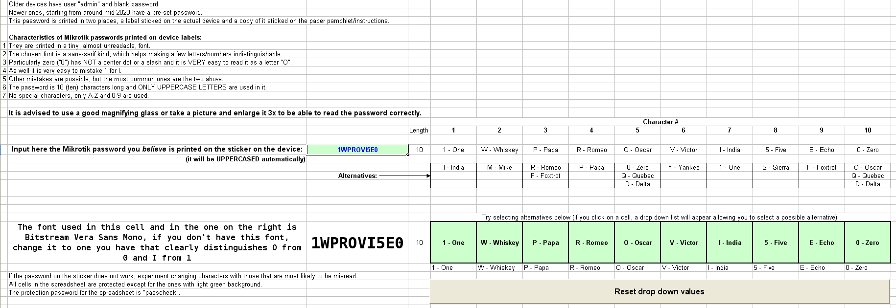

I have put together a small spreadsheet that may help when there is trouble logging in the first time on one of the newish Mikrotik devices that come with a factory default password printed on the label on the device.
The spreadsheet is (should be) self-explaining:
I am attaching it in two versions, one with some added VBA code that automates some things and one "novba" for people that do not run Excel or that are paranoid and believe that spreadsheets with VBA code are a risk, of course this latter needs some little more care when playing with it as everything is "manual".
passcheck.zip (18.6 KB)
passcheck_novba.zip(12.5 KB)
I am not too sure that the information in it is complete and accurate, I am posting it below for review and comments:

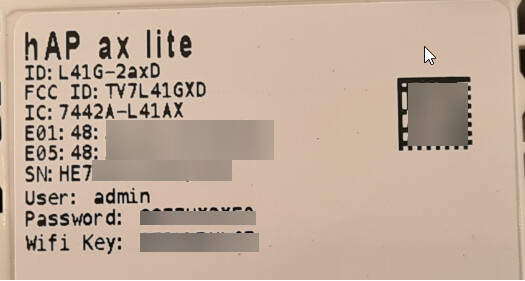

1: has been corrected lately. I still do have a problem though for some devices where there is really a lot of white space so the font could easily have been made larger. But alas ...
Example:
Even recent Hex S has this "problem".
3: latest devices I have seen either have striked zero or no 0 at all in passwd They try to avoid ambiguous characters now.

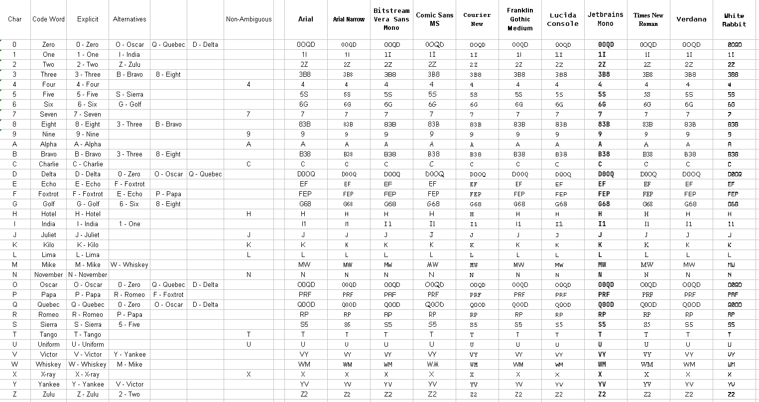

In the meantime I made a quick table with some common and some less common fonts to see how it can actually look.
The surprises (to me) are that the so-much-hated Comic Sans is not that bad, and that our "resident" code font Jetbrains Mono while making easy to distinguish 0 and O, is not so good at 0 and 8 and O and D :grimacing::
08B80ODO
