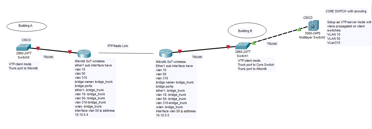

I have to MK SXT Wireless connected to link 2 offices.
I have 2 CISCO switches ate each sites that they are connected to. Somehow i cannot get the Trunk and VLAN to work based on my configs.
I want to pass 2 vlans via the wireless link.
I have setup trunk on both my CISCO, and created sub interfaces for vlan 50 and vlan 310.
Its not working. See image of what i want to achieve
The picture is clear, but the configuration expors from both SXTs are missing. See my automatic signature for a hint.

Hi this is a more detailed photo.
Please disregard the other ip address 172.16.x.x, it has been removed.
right now the configs is as follows, the 10.10.5.0 address are for management only, and the are on the interfaces vlan 50 on both routers. it is not the issue.
Issue is i cannot get the trunk working from CISCO to Mikrotik. i get vlan mismatch each time.

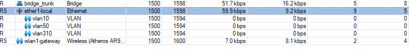

My ether1 on both MK have vlan 10, 50, 310 as its sub interface.
and ether1,wlan1, vlan 10,50,310 are all members of bridge_trunk.
see photos below

You assigned the vlans to ether1 and not the bridge…
Furthermore vlans are NOT bridge ports…
The VLans are assigned to the the bridge in PORTS
