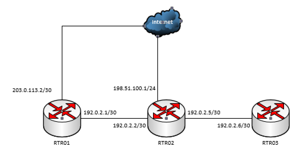

I came across a strange issue when doing some traceroutes through, from and to our network. With multiple upstreams and BGP there is often asymetric routing because my routing policy towards an external network might be different than the policy of that network towards me. This might lead to ICMP packets for traceroutes enter a router through ether1, reaches it’s max TTL there but the reply has to be send through ether2 because that might be the best path back. In RouterOS 7.2.3 this leads to the behavior that the IP adress of the reply is not the IP adress of the interface the ICMP-packet entered the router but the IP adress of the interface it leaves. Sound irrelevant but that way I have interfaces in the traceroute the original packet never traveled through. This is at least confusing.
Example:
Because of stupid routing policy a host in the internet sends packets in our network through provider connected to RTR01 but our routing policy says IXP connected to RTR02 is the better path back. So packets to RTR03 will travel 203.0.113.2 → 192.0.2.2 → 192.0.2.6 and the replies will travel 192.0.2.6 → 192.0.2.5 → 198.51.100.xxx. So traceroute from the internet should look:
  1     1 ms     2 ms    <1 ms  internet-host.someprovider.net [1.1.1.1]
  2     1 ms     2 ms    <1 ms  ether1.rtr01.mynetwork.net [203.0.113.2]
  3     1 ms     2 ms    <1 ms  ether1.rtr02.mynetwork.net [192.0.2.2]
  4     1 ms     2 ms    <1 ms  ether1.rtr03.mynetwork.net [192.0.2.6]
But actual traceroute looks:
  2     1 ms     2 ms    <1 ms  ether2.rtr01.mynetwork.net [192.0.2.1]
  3     1 ms     2 ms    <1 ms  mynetwork.peers.ixp.net [198.51.100.1]
Can this please be changed? Asymetric traceroutes would be even more misleading if it stays the way it is now. This way it seems the packet leaves the network to the IXP while traveling through the network wich is not the case.
