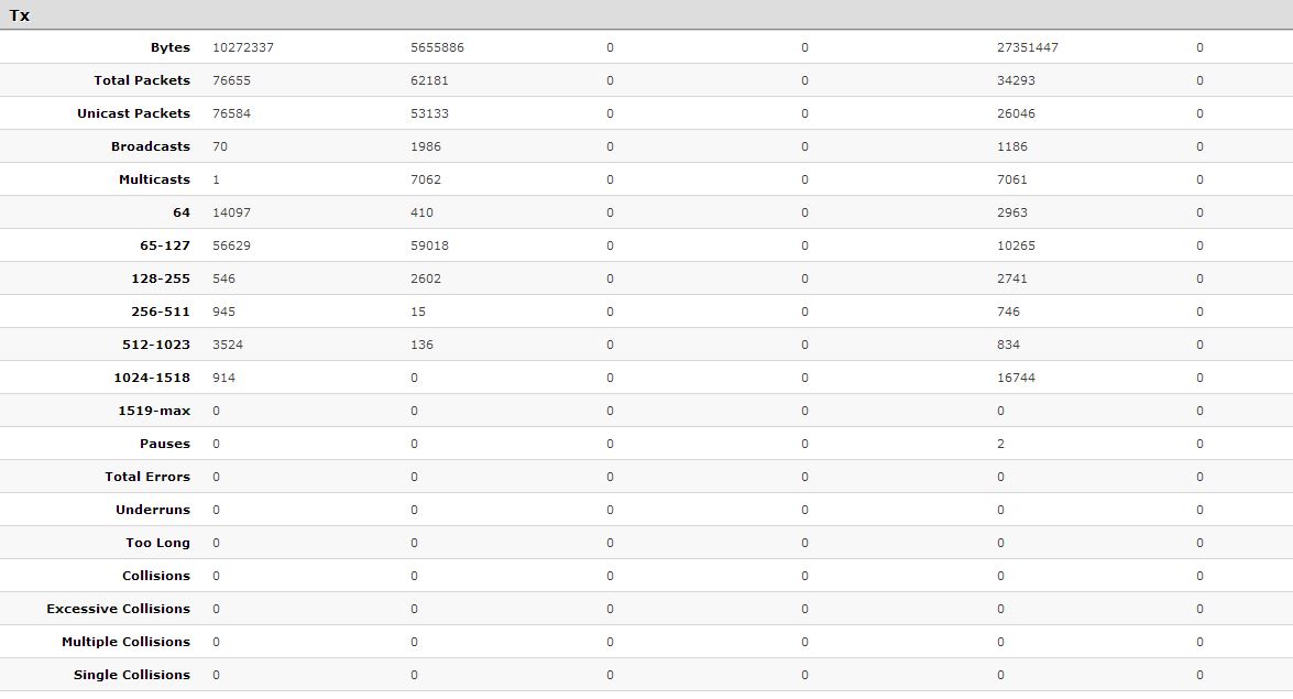

TX pauses frame with flow control disable
I’m using RB260GS with 1.12 firmware.
I disabled flow control on all ports but I’m still seeing TX pauses frame on single ethernet port.
Why the switch is sending out TX pauses frames with flow control disabled ?

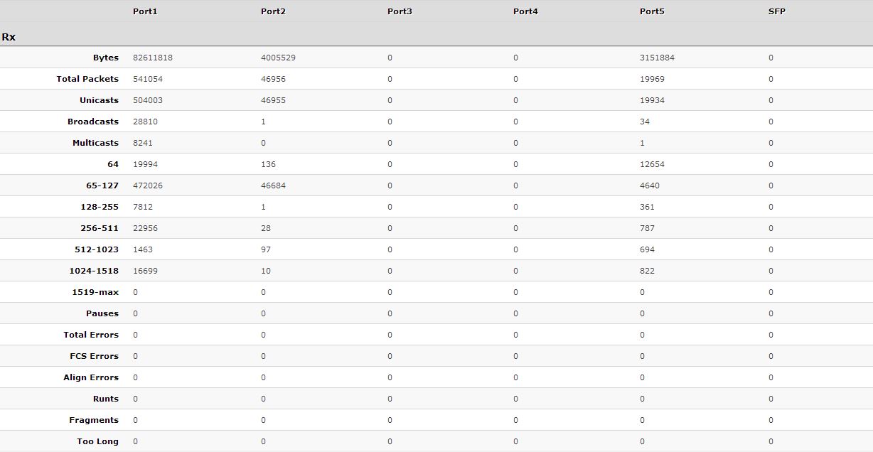

I’m attaching TX & RX screenshot.
