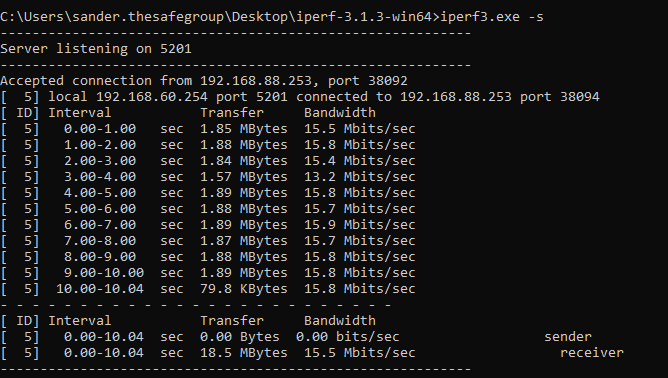

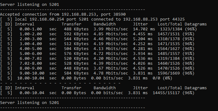

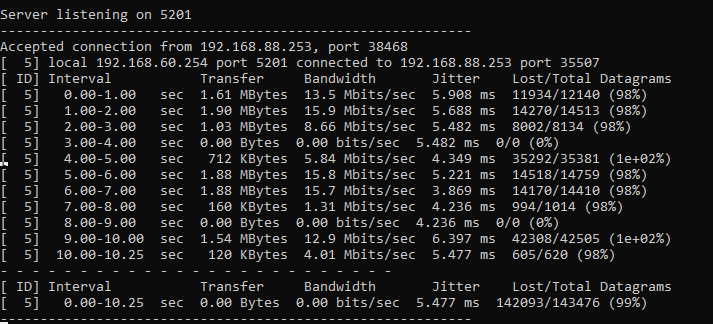

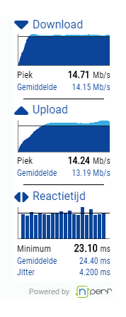

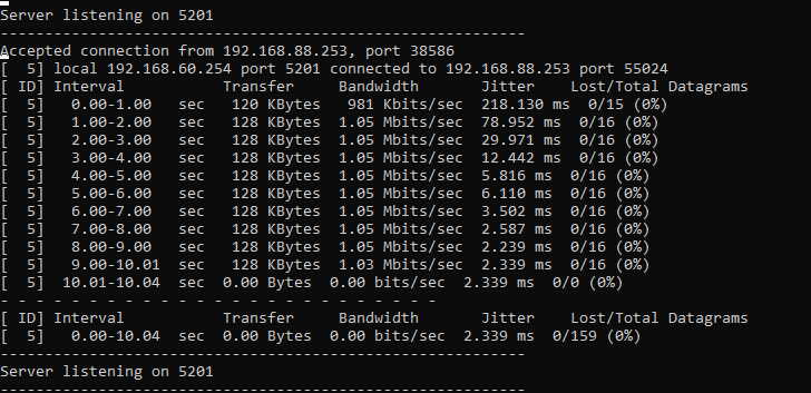

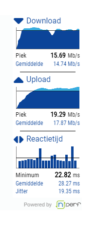

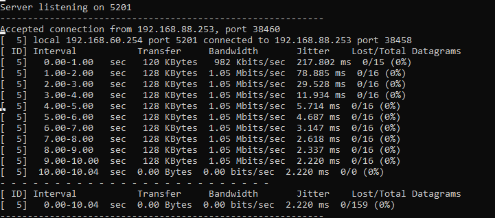

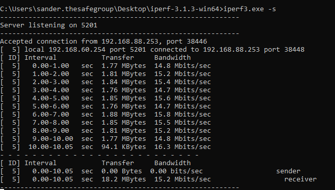

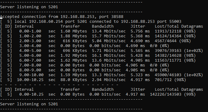

We were very excited about the support for udp ovpn tunnels because of the possibility for greater speeds. But when I tested the speed over different tunnels, there was no difference between the TCP and UDP tunnel.
I tested with 2 x RB951G-2HnD with ovpn tunnel in between. Behind every RB there was a laptop with iPerf and a Gigabit ethernet port.
The results of the test can be found in the attachments. The difference between TCPovpn and UDPovpn is very small. I also did a speedtest over the ovpntunnel (behind isp connection of 250 Mbps) and there is very little difference in the overal speeds (TCP got faster speeds than UDP).
Is there a reason why the UDPovpn tunnel isn’t faster than the TCPovpn tunnel or is this a bug?
