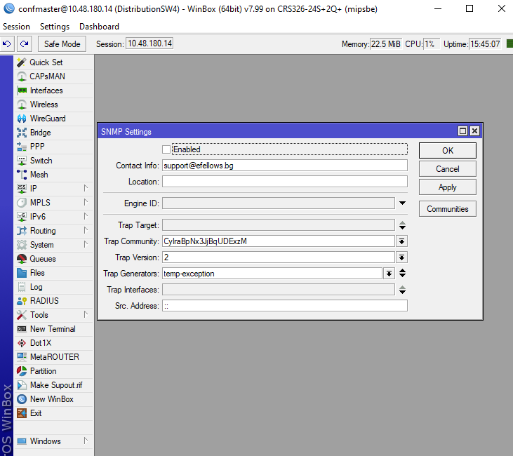

  • Disable SNMP. I know that disabling SNMP also reduces monitoring capabilities, but we need to ensure that the monitoring does not cause memory leaks under some conditions. As a temporary alternative, you may login via ssh and run:
/system/resource/monitor interval=5s without-paging
This way, you still notice an increase in memory usage or device reboot.
Hello Team,

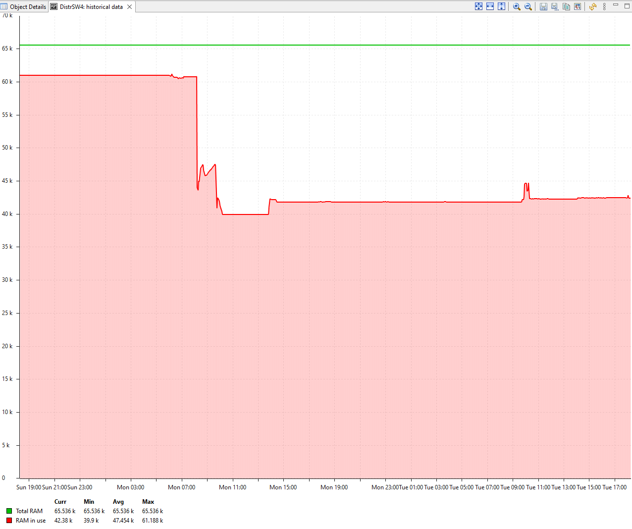

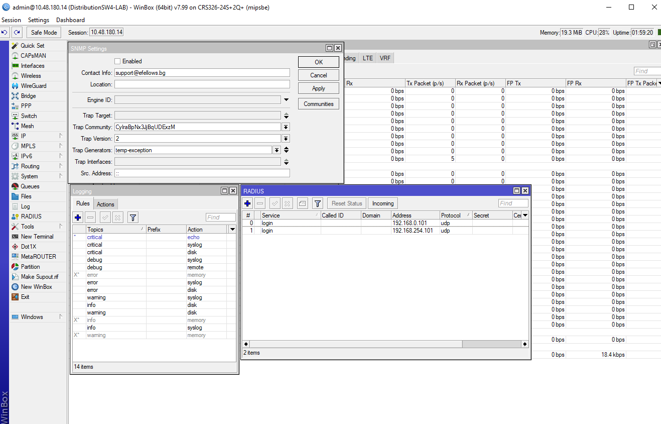

We have progress here. After disable SNMP, logging on disk and Radius on Distribution 4 RAM is stable from 15 hours. Today we started processes: logging from disk and Radius on Distr4(RAM continue be stable). From 2 hours we stopped only SNMP on Distr4-LAB and situation is stable RAM. I attach screenshots from devices.

Hello Team,

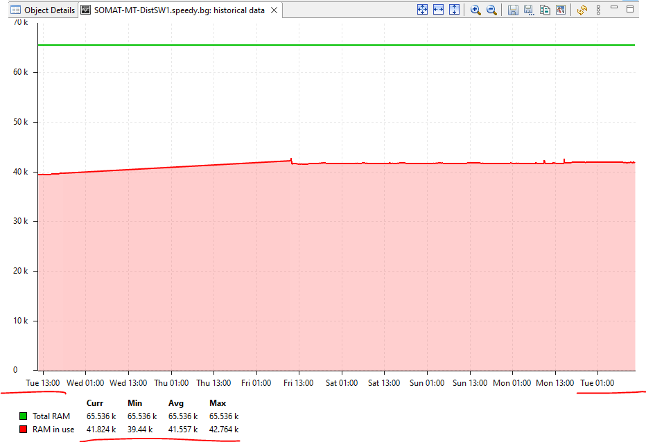

I update ticket with some information about our issue. From 1 week there no change in situation. DistrSW4 with only SNMP service stopped is super stable. Only in this switch we have attached clients. We have one switch DistrSW1 with active service SNMP and it is stable too. All other switches is with stopped SNMP and no problems with it. The picture is that: devices without clients attached on it worked correctly( with or without SNMP), but if we have clients attached and SNMP is active, RAM started to grow and switch is restarted.

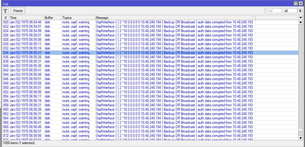

We install additional 3 CRS326-24S+2Q+RM with version 7.99-2 in the Production environment we had the problem with OSPF routing protocol with
following error and the neighbors stuck in Exchange status.
OspfInterface { { 2 *18 0.0.0.0 0 10.48.248.194 } Backup DR Broadcast } auth data corrupted from 10.48.248.193
After we disable OSPF authentication it works fine.
An issue with OSPF authentication will be fixed in the next version.

Please upgrade to RouterOS v7.1rc7. The OSPF authentication issue should be fixed there.
