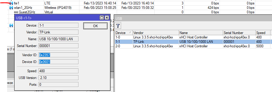

Same here…
USB 10/100 LAN
vendor id: 0x0fe6
device id: 0x0fe6
it recognized as LTE
