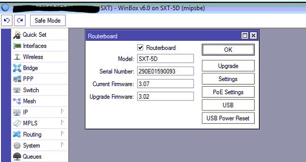

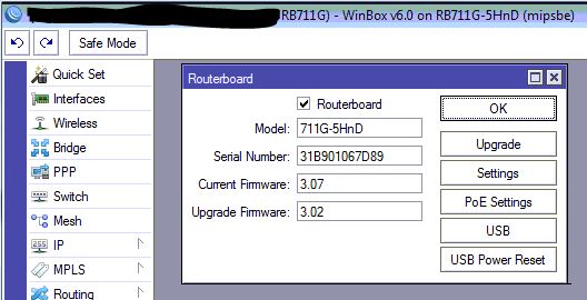

I just upgraded from Ros5.25 on a RB433, RB750G, 5Ghz RB711G and SXT
All of them were running firmware 3.07 (that came with Ros5.25), but now the SXT and 711 state that their latest available firmware is 3.02?
Is it safe to run 3.07 on them or should I downgrade to 3.02 for those 2 routers.

PietRetief, both firmwares are working ok. We will update to the newer firmware for those boards in next RouterOS release.

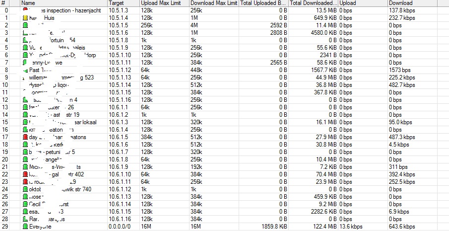

My Simple queues stopped limiting the upload side on all the boards I upgraded to 6.0, Download limit works fine.?
post your queue config. how did you check that they are not limiting? which version did you have before upgrade?

They were all between 5.18-5.25. All are either 433ah boards or 435G. MY x86 system running ros v.6rc11 also works fine. Its only the 5 or 6 boards I upgraded last night to 6.0 that does this. Check the file attachment, its not showing any upload traffic. all 0
Nevermind i’ve found the problem, its the “everyone” queue at the bottom, when i disable that the uplaod traffic starts running, was just a nice way to check the traffic going out of the board :confused:

To Chrisdewit:
My guess is you have queue Nr:29 (named “everyone”) as parent to all other simple queues.
Am I correct?
To fix your queues change target from 0.0.0.0/0 to 10.5.1.0/24 or specify target as interface name where clients are connected, everything should work normally
Now, lets think - can all the traffic (from and to your clients) can be considered as download from 0.0.0.0/0 ??? Yes, it can!
so nothing is left as upload.
