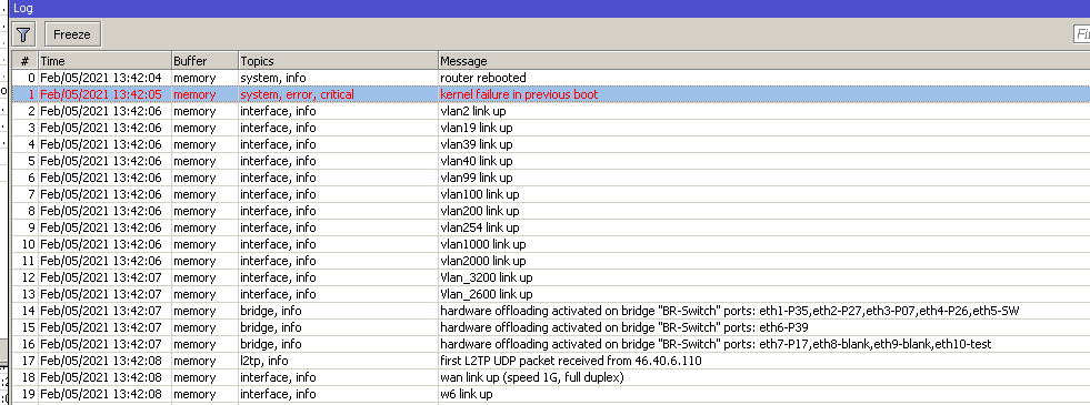

could not upgrade from 48 to 48.1
kernel failure in previous boot
rb3011
