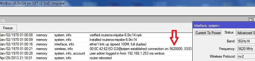

All V6rc show bad frequency in LOG

That’s the frequency in kilohertz, just like the atheros driver under linux reports it.
