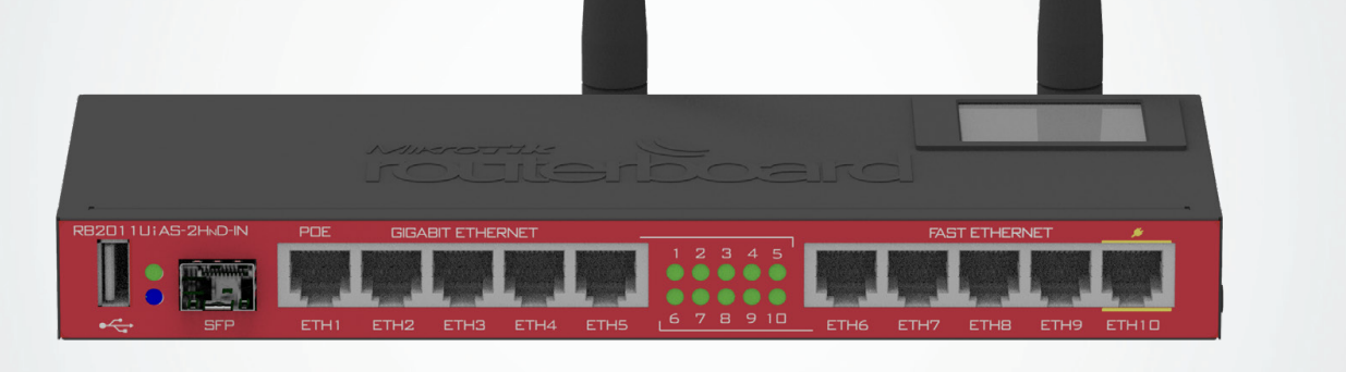

2011UiAS-2HnD here, all ports 6-10 are now only negotiate at 100mbit.
Those ports are 100Mbps by design, they always were 100Mbps.
Right you are, strange … someone must be playing tricks on me and swapped some cables around :slight_smile:

Port 1-5 are gigabit
Port 6-10 are 100 MB
See picture:
