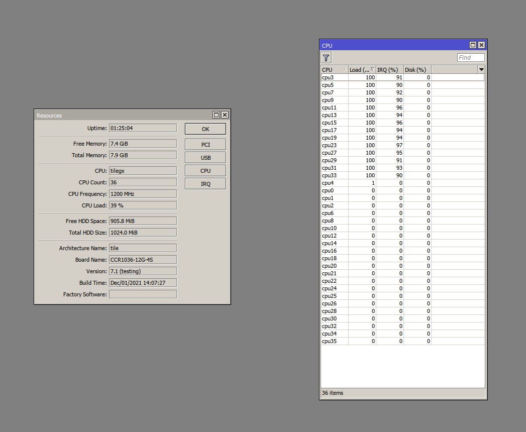

first problem by me, on ccr1036 suddenly high cpu usage
no traffic at all, after restart it’s good so far
And you didn’t think to check the profiler to see what was actualy eating the CPU, did you?
And to see which of the IRQs were used that much..

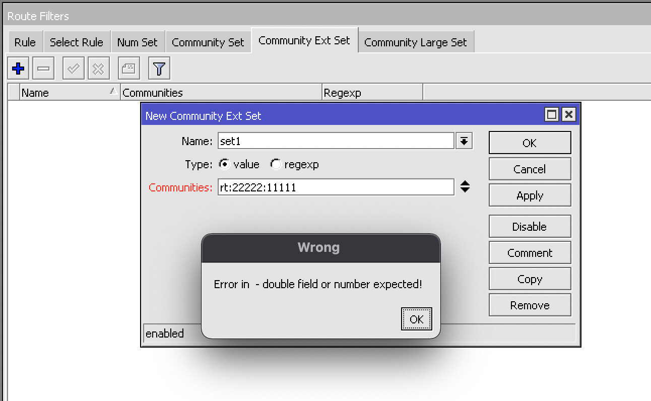

Erro Community Ext Set
