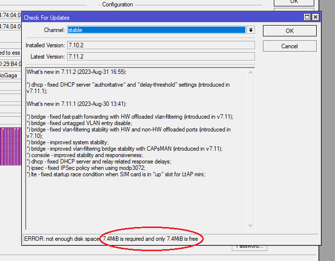

(see pic, on an RB981-2nd-TC)
That’s a model that exists just for you…
However, if it were the RB941-2nd-TC, as written everywhere, and as common sense dictates, RouterOS 7, even if they compiled it, is not for SMIPS.

(Apologies, I have an RB941 indeed)
You mean, Winbox downloaded a wrong firmware so far? (some weeks ago, it upgraded from v6 to v7 and then to 7.10.2 without any complaints)
Somewhere when moving from 6 to 7, someone must have done something special because ROS/Winbox does not upgrade automatically from 6 to 7.
You have to select to do that.
Apart from that, even though it is possible, it is not recommended to use ROS7 on a device with less then 64Mb RAM.
You can always downgrade.
Well, that probably requires a netinstall by now… even within v6, upgrading such devices often was problematic.
To downgrade my RB941 to v6, I followed the advices at
https://help.mikrotik.com/docs/display/RKB/Downgrading+RouterOS
  • downloading routeros-smips-6.49.10.npk (latest v6 Firmware)
  • uploading it via winbox to the router
  • issuing /system/package/downgrade at console
It didn’t come to /system/reboot, because the downgrade command announced and seemingly performed it on it’s own.
The session closed, but then no more reconnection was possible. The device appears bricked now.
I am tired of the crappy information provided. Is anybody here able to articulate some helpful cue?
I said it was possible to downgrade.
I did not say how.
Pe1chl told you how.
Netinstall.
