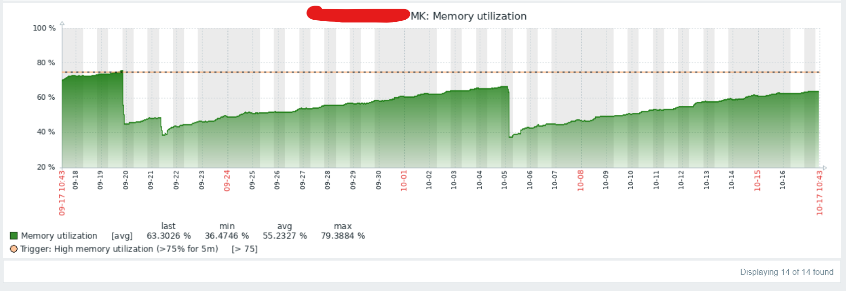

I’m seeing what appears to be a memory leak on v7.11.2, likely related to the DNS resolver once again. Have already reported, with supout files, as SUP-128622 on September 20th, but absolutely no answer there, almost one month after the report with detailed data
Posting here to let people aware that some memory leak is still present on v7.11.2 and, by my own analyses of the supout files, it’s once again DNS resolver related (no confirmation from Mikrotik at this one). While I have other that are not presenting the behavior, the faulty behavior (and screenshot) was taken from a RB2011 box.
In fairness to the poor DNS server… maybe it’s related to the architecture. Is there something that point at DNS, other than DNS has had memory leaks before? It seems if DNS is leaking, it be more widespread.
For sure it might be arch related, I also considered that. Thing is that even other RB2011s i have running the same RoS version, the leaky behavior can’t be seen. After decoding supout files before and after a reboot (attached to my bug report), I can clearly see the /nova/bin/resolver process is the one using much more memory than likely needed, so I’m pretty sure (to my best knowledge) that it’s DNS resolver related. Might have other variables as well, but I couldn’t find any. Was expecting Mikrotik Support to pay some attention to my bug report, but it’s almost 1 month old and no interaction at all from Mikrotik there :frowning:

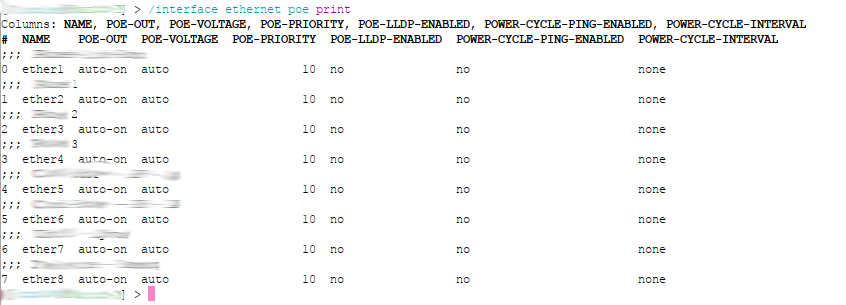

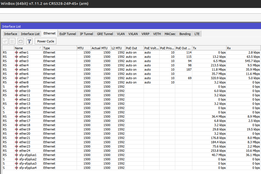

one of my CRS328-24P-4S+ don’t know about PoE on interfaces 9-24, however PoE on theese ports still works…
Same model, with same RoS version, but different device this problem haven’t.
Any idea?
