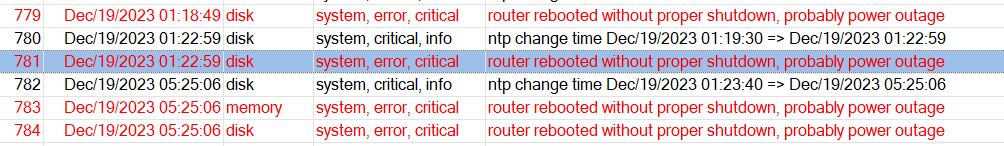

I’m getting 1 or 2 reboots a day in my RB5009 since upgrading 7.13, no sup file creation. Though I don’t use VPLS…
No such thing here.
Stable since update last Friday.
