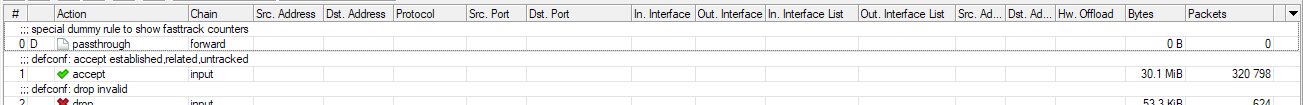

In my case, I’ve experimented with the “WAN under Bridge” configuration in the past week on my RB5009. My WAN is a PPPoE connection over a SFP GPON module, which requires no VLAN tagging, so when I put sfp-sfpplus1 under the Bridge I set a dummy PVID 1000 for it with frame-types=admit-only-untagged-and-priority-tagged and configured th PPPoE connection to use the interface vlan1000 under bridge, everything seems to work fine. The bridge ports are all shown with the H-flag active and bridge-fast-path-active is on. My LAN only uses VLAN, the bridge interface with PVID 1 is not used (no IP address and DHCP). The router has no problem with WAN speedtest around 2-2.2Gbps (the limit of my line) for both IPv4 and IPv6.

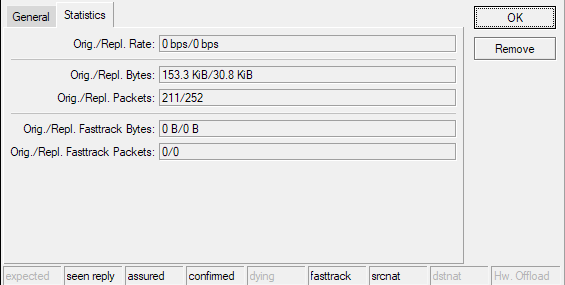

However, I noticed that IPv4 Fasttrack doesn’t work anymore. All the dummy fasttrack rules are still listed under the tabs of the IPv4 firewall window in WinBox, but they all have counter == 0. Most of the IPv4 connections listed under the Connections tab do have the F flag active (fasttrack not greyed out in the status bar). But the counters are all 0:
Using “Profile” I could see that the “firewall” task now use about 3-4x more CPU, but the RB5009 can still handle everything without a problem. If I pull sfp-sfpplus1 out of the bridge and set PPPoE to use it, the fasttrack counters increase normally and the CPU usage for “firewall” drops.
