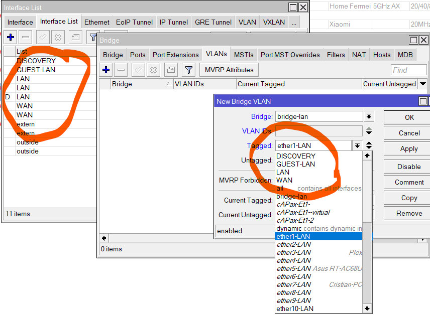

*) bridge - add HW offload support for active-backup bonds on 98DXxxxx, 88E6393X, 88E6191X and88E6190 switches;
*) bridge - added interface-list support for VLANs;
What does this mean?
Is possible now to add interface-list as tagged or untagged interface.
Seems that you have not read previous post about the same.

  1. *) bridge - added interface-list support for VLANs;
Does this mean we can now list the bridge as an interface list member and this will include all vlans attached to the bridge?

  1. You can use interface-list for “tagged”, “untagged” properties under the /interface/bridge/vlan menu.
    https://help.mikrotik.com/docs/spaces/ROS/pages/328068/Bridging+and+Switching#BridgingandSwitching-Interfacelists
