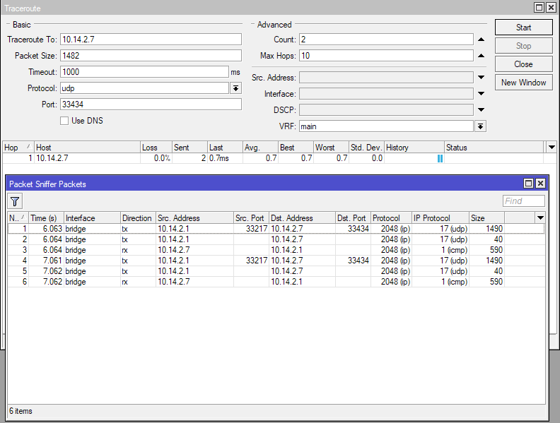

I wanted to test whether the problem is solely caused by User Manager, or whether RouterOS 7.17 is unable to properly fragment UDP packets. At first, I tried Traffic Generator, but it doesn’t seem to automatically fragment UDP packets. Luckily, there is another tool in RouterOS that allows sending UPD packets with arbitrary sizes, and that’s the Traceroute tool in UDP mode (instead of ICMP). However, the Packer Size field doesn’t allow any value larger than 1500. So, the next logical step is to reduce the MTU on the (VLAN) interfaces. At first, I reduced the MTU down to 1480, but the packets seem to be broken up at the 1476-byte mark anyway, so there is no difference between MTU 1480 and MTU 1476 for the following findings.

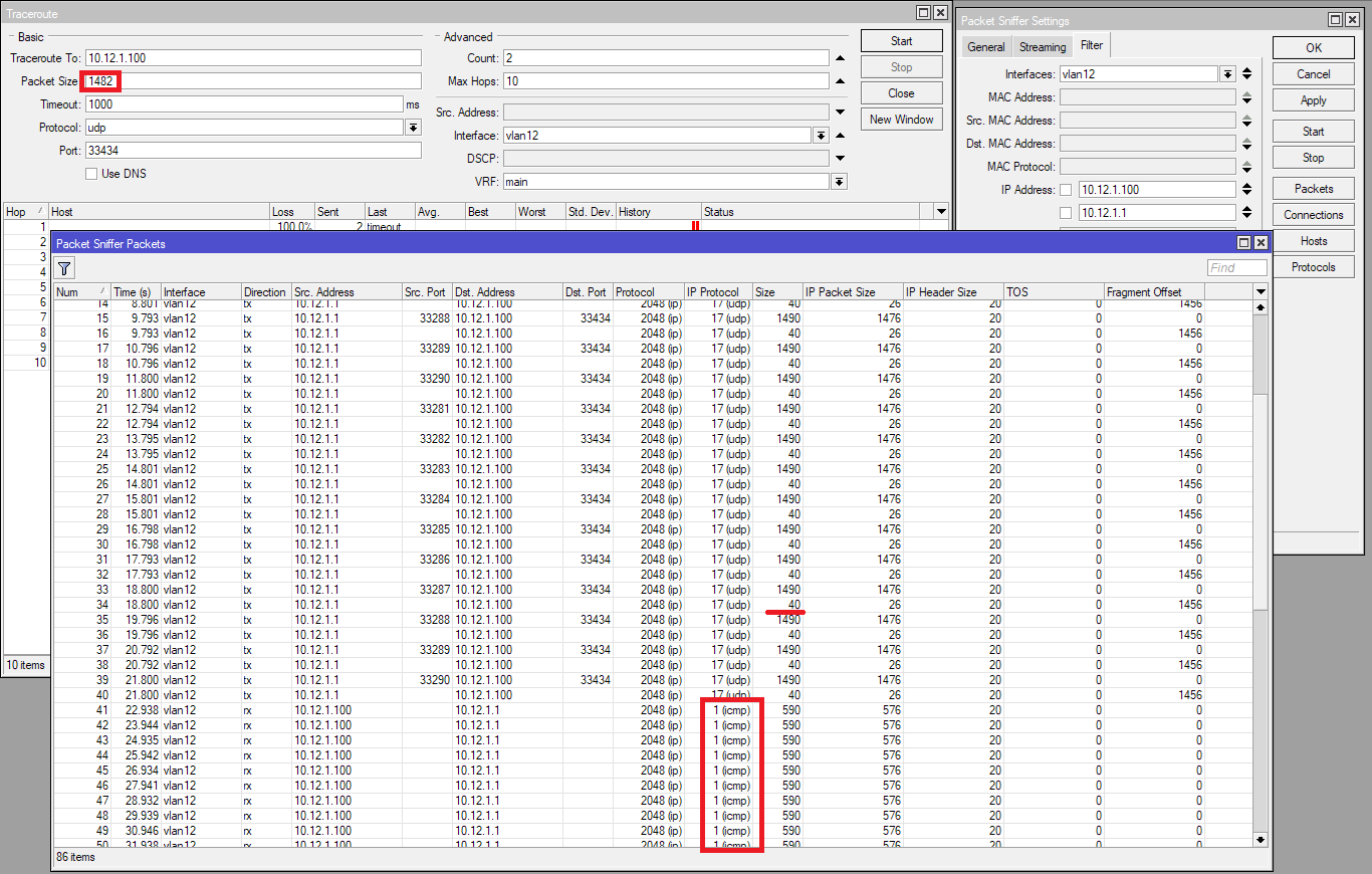

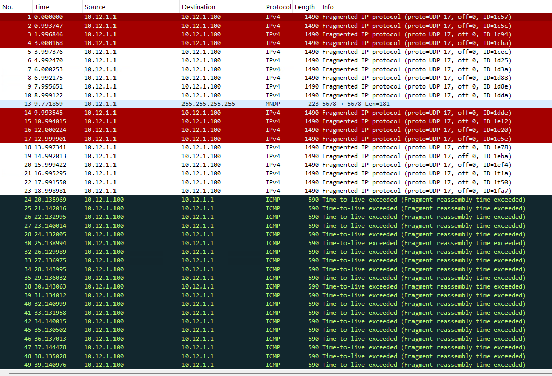

With the MTU set to 1480 (or 1476), I used Traceroute to send UPD packets to a Windows machine running Wireshark. Windows doesn’t support UDP traceroute but that’s not important because I only wanted to capture the incoming packets. By setting the traceroute Packet Size to 1482, I got the same fragmentation where the 2nd fragment has the same 40-byte frame size:

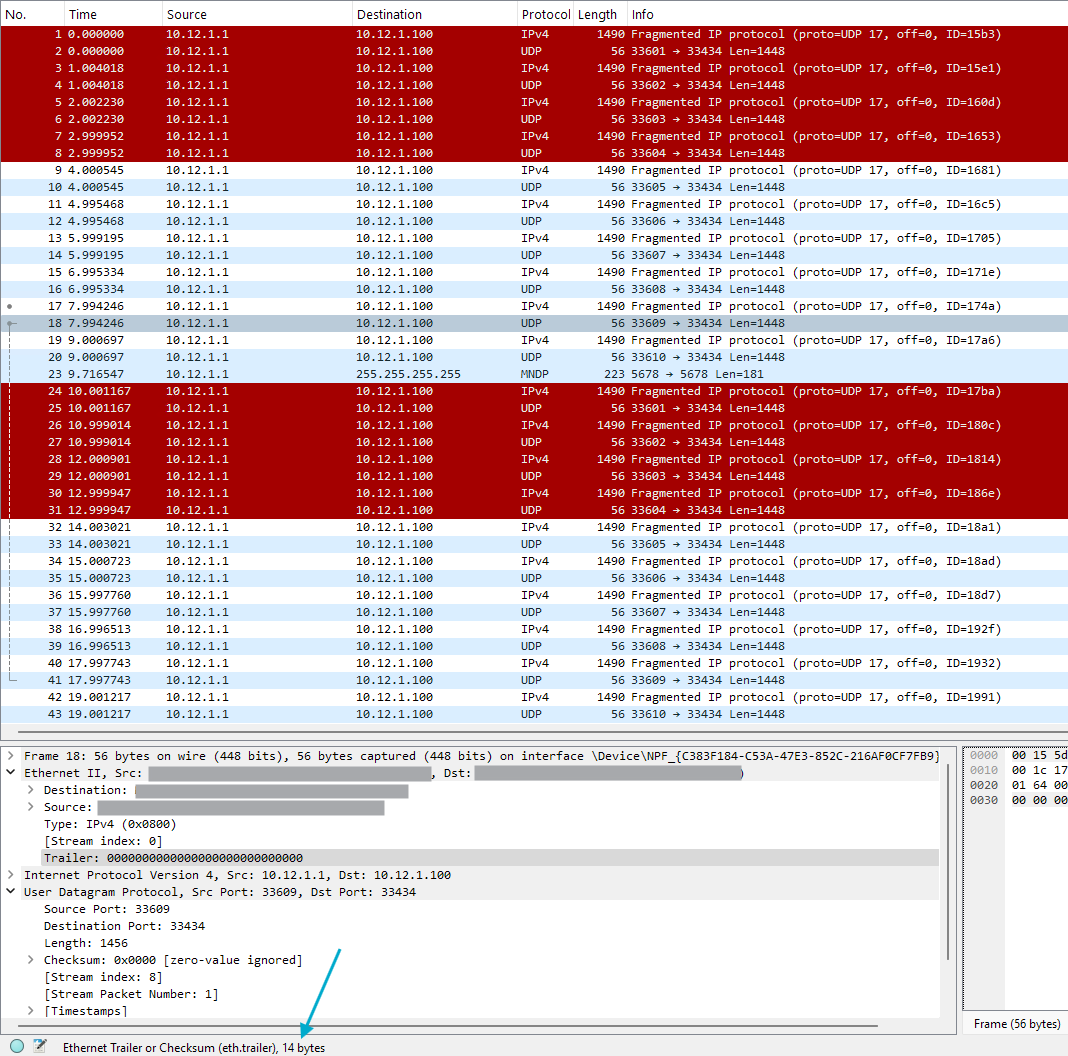

And the exact same issue as the one with User Manager happened. After a while the Packet Sniffer showed a bunch of ICMP packets. On the Windows machine, Wireshark showed that the 40-byte frames never arrived, only the 1490-byte ones. And Windows sent the ICMP Fragment reassembly time exceeded responses.

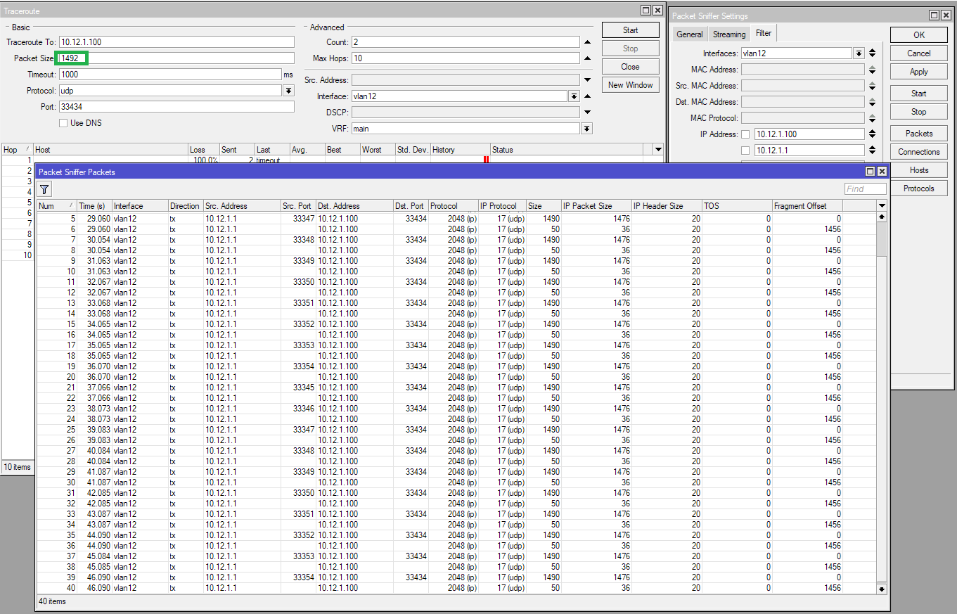

But at this moment, with the MTU set to 1480, the same RADIUS authentication tests with eapol_test suceeded! Obviously, with smaller MTU the 2nd fragment got bigger. So I tried to increase the size of the traceroute packet to 1492:

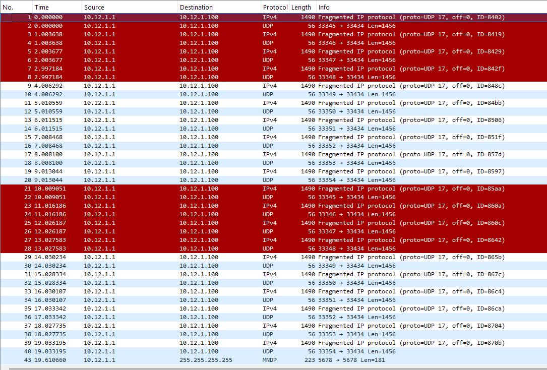

Packet sniffer showed the ethernet frame size of the 2nd fragment to be 50 bytes. This time there is no ICMP packets. And on the windows machine, all packets have arrived! But the 2nd fragments have a frame size of 56 bytes. With trailer inserted at the end.

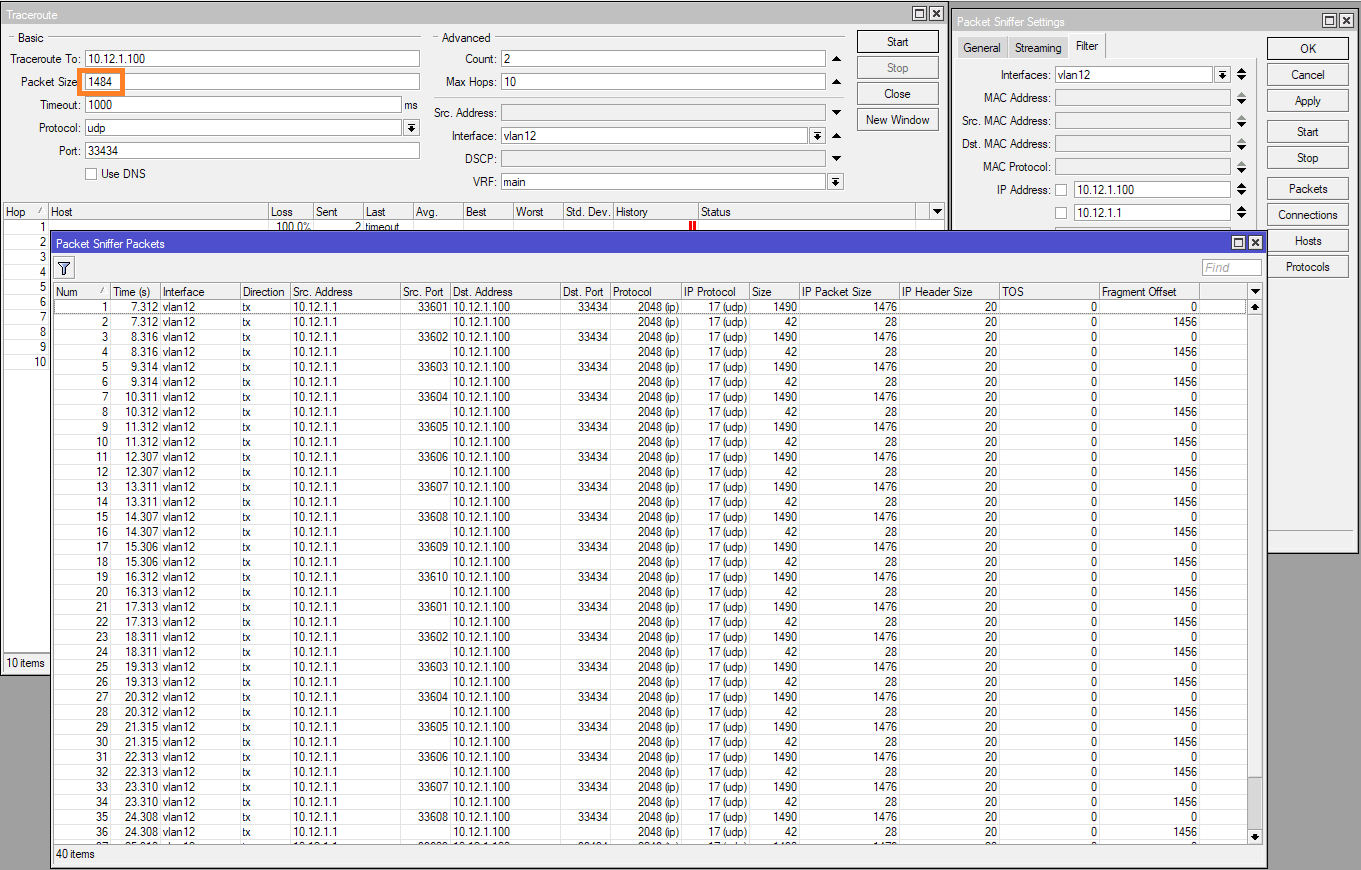

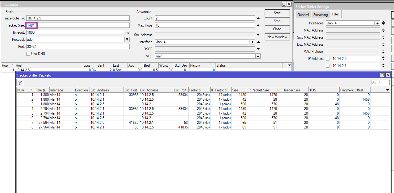

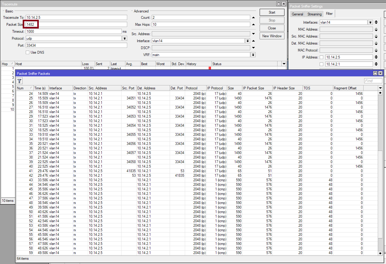

Next, I tried to increase the traceroute packet size from 1482. At 1483 bytes, a 41-byte 2nd fragment was produced, but also disappeared and never arrived. At 1484 bytes however, just two bytes larger than 1482, the fragmentation worked, and the Windows machine could reassemble all the UDP packets:
We can also see that the 2nd fragments are listed as having a 42-byte framesize on ROS, but were sent as 56-byte frames with 14-byte trailer:
When I changed the traceroute target to one UniFi AP, which runs Linux, the traceroute worked with packet size 1484 (because the AP understands UDP traceroute and can respond), but also failed with ICMP fragmentation timeout when the packet size was reduced to 1482 bytes.
It looks like RouterOS is unable to append a 15- or 16-byte trailer, so that the ethernet frame sent can reach the minimum allowed size? Am I unlucky that my certificate size somehow causes User Manager to produce UDP packets that cause fragmentation with the 40-byte second fragment (at MTU 1500)? Maybe I should try to add some junks into the different fields of the certificate to make it larger :upside_down_face:?

I went ahead and upgraded the hAP ac² to 7.17rc6. And now the bug is reproducible there too. With no configuration changes (MTU was 1480 same as with the 7.16.2 tests) the router can no longer send the 1482-byte traceroute to the same AP as from the post above.
But 1484 worked:

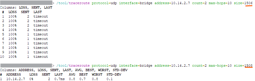

I just noticed that the command line allows entering packet size > 1500 bytes. Which means running the traceroute test with MTU 1500 is possible too. Here is the result which shows the problem when there are 6 extra bytes that need to be transferred:
All tests with packet size 1501-1507 failed. It worked for sizes <= 1500 and >= 1508.

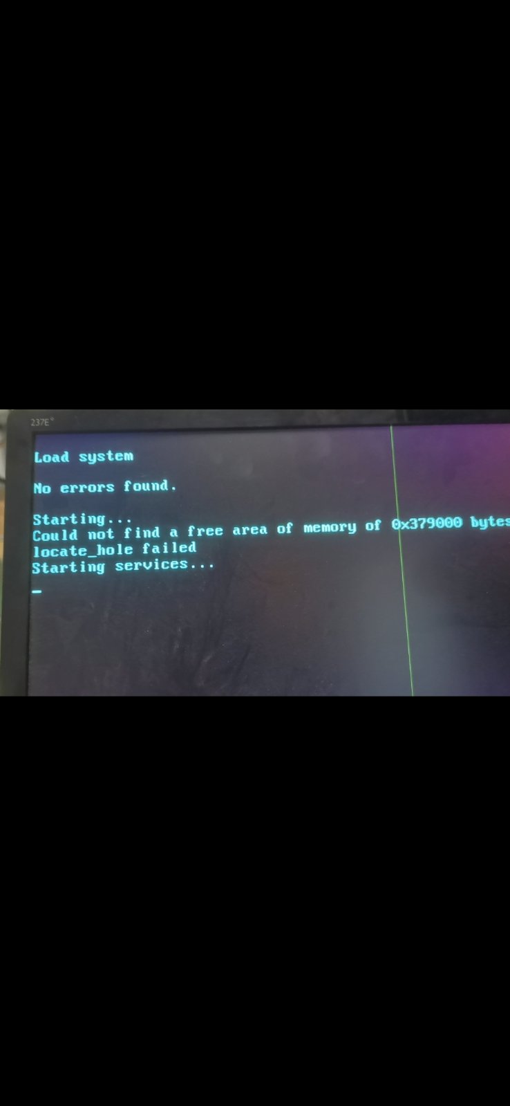

Hello! I need help from support - after upgrading from ros7.16.2 to 7.17rc6 i have loop reboot on my x86 machine. Just tried to change PC to other with same disk - still same problem. How can i solve this problem without reinstalling system(i dont want to loose my license)? Disk is Transcend DOM SATA 2GB
Photo of screen stuck:
