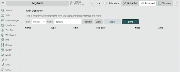

*) webfig - Skin Designer moved to centralized page (additional fixes);

*) webfig - Skin Designer moved to centralized page;
