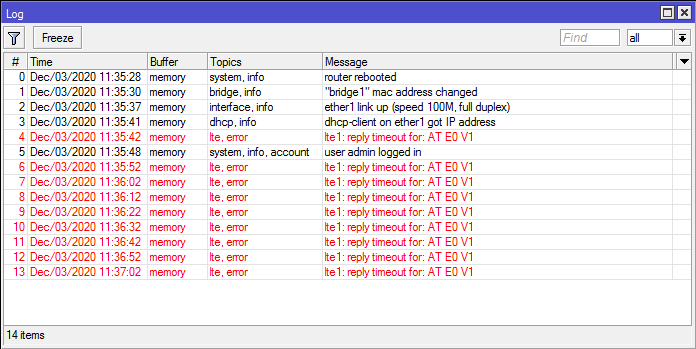

Lost lte1 interface after upgrade from v7.1beta2 to v7.1beta3. Sierra Wireless MC7430 in wAP R. Log file reports ‘reply timeout for: AT E0 V1’ (see screenshot).
